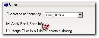

    No - if it is a pioneer then you should choose the following option:
    Even if it is not it is worth a try.

    Nope, no joy, the machine isn't a Pioneer, but using the Apply Pan & Scan info doesn't do anything different.
    The whole picture seems to have shifted to the left about 30% on it's X-axis. So the you get the last 2/3's of the picture appearing flush to the left, then at the very right hand side of the screen you get what should be the first 1/3rd.
    Any further ideas ?
    Thanks.
