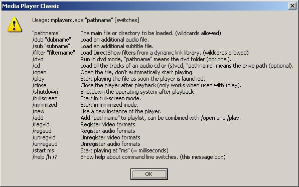

As for full screen, add /fullscreen to the command line, so that it reads:
Here's all the switches you can have:Code:open=MPC.EXE /fullscreen /play /close VIDEO_TS/VIDEO_TS.IFO
