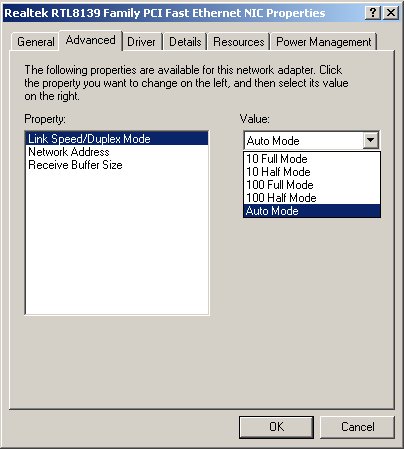

Right-click on My Computer, and go to Properties.
Click on the Device Manager button.
Expand Network Adapters and you should be able to find your NIC listed there.
Right-click on it and go to properties.
On the Advanced Tab, there should be an item called "Link Speed" or similar.
Setting this to "Auto" should work, but you can always set it to "100 Full Mode" (in my example, yours may be worded differently) to force it to connect at that speed.If in doubt, Google it. -

jimmalenko's method work perfectly. In fact my configuration was already set to 'auto', so i chose '100mb full', which still connected at 10mbps. so i tried changing it back to auto for some reason, allowing me to connect at 100mbps again.
hope that helps, and thanks again
