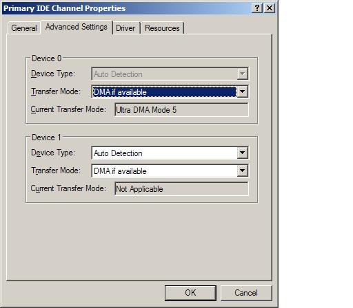

Go to your window device manager and check your hard disk if it's set to DMA mode.
If you are capturing from analog source (not via firewire), then you need to install a codec. PicVideo MJPEC works best for AV_IO. -
