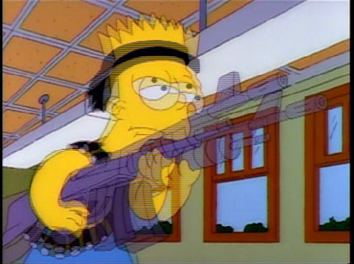

  3. Ok, I did my homework. Yet I have a question:
    What would be the best way to apply resize and de-interlace filters to this source?
    I am trying avisynth with dgdecode and decomb:
    A)
    MPEG2Source("D:\Temp\The Simpsons [S04xE01] Kamp Krusty.d2v")
    FieldDeinterlace(blend=false)
    LanczosResize(576,432)
    But I got better results with this profile:
    B)
    Telecide()
    Thanks fot your time.
  4. Hi-
    You don't use Telecide to deinterlace. It's the first part of the Telecide/Decimate IVTC combo. It's true that it does have FieldDeinterlace(Blend=True) built into it by default, but you might as well use FieldDeinterlace by itself if the plan is to deinterlace. And KernelDeint is a better deinterlacer.
    However, you should be able to IVTC it back to 23.976fps, I think. You said the second script worked better (I can't tell the difference between the pics, as it's too bright where I am at the moment). Try adding Decimate() after Telecide() and see if you get smooth playback.
    And which version of Decomb are you using? If the recent, then you probably want:
    AssumeTFF().
    Telecide(Guide=1).Decimate()
    Read the Decomb Reference Manual for more information.
  5. I tried your script:
    AssumeTFF().Telecide(Guide=1).Decimate()
    But that didn't result in a smooth playback, as you can see.
  6. My mistake. I just found that this behaviour occurs only if LanczosResize stays before the decomb parameters.
    Anyone knows the reason for that?
    The actual script I'm using is:
    AssumeTFF()
    Telecide(Guide=1)
    Decimate()
    LanczosResize(512,384)
    Looks promising...
