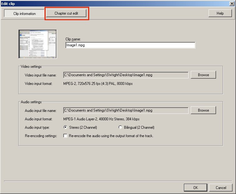

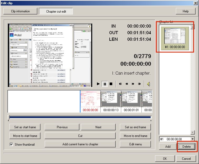

When you add first file you will then see a tab that says chapter cut edit. Click on it. Now click on 'ADD' down at the bottom right. It will prompt you to insert chapters and it gives approx 3 or 4 options-i usually go with a set no. of chapters but thats upto you. Once done click OK.

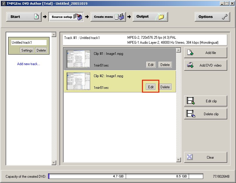

Now Add 2nd file and do the same except that when you do chapter cut edit on the 2nd file make sure that your chapters are inserted differently, eg. insert at specified time code, at so many minute intervals etc.

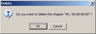

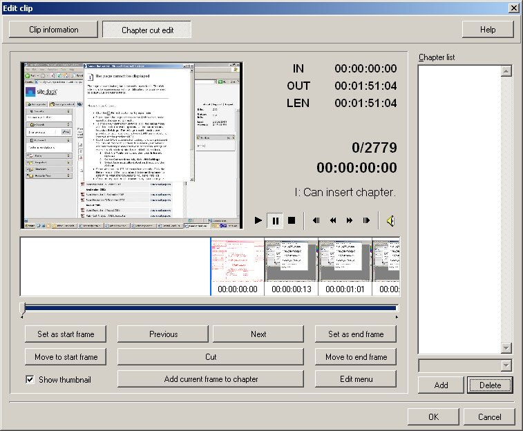

Possible Alternative:-Now i do not know if this works or not because i haven't yet tried it. This is for 2nd file added only-When you've added your chapters you will see on the right hand side a no. of thumbnails corresponding to the no.of chapters selected-i'm not sure if its possible to edit the first chapter point of the 2nd file added just there. I'm sure there are 2 'edit' 'delete' boxes if memory serves me right-apologies if not (alzheimers!!!) Give it a try-you wont break it. I hope its helped. -
Here's me typing all that lot and Jimmalenko nails it in half a sentence!!!I'm sure there was a delete option but my brain is totally fried-its almost 2am here now. At least you have the hang of insert chapters now at least.
