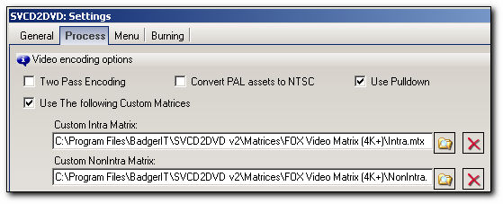

Thanks to somnus, here are some custom matrices for you to try:
http://software.badgerit.com/Releases/Matrices.zip
Usage:
Just setup in SVCD2DVD Settings:
Here are the comments from somnus:
Here's a start to some matrices people can use I put 7 in the folder most people will probably only use a couple. I have them label for what bitrate they should be good at except for QLB, but it works good for me around 2000-2500. The high bitrates will work good for 4000+ files which would probably be Divx and Xvids or HD streams, wouldnt be usefull for pal to ntsc mpg conversion but the others around the 2500 range would be. I can add a lot more for whoever wants to try different ones, everyone seems to have thier own opinion what looks good.
Oh and I included to Test matrices I extracted from the movies Tombstone and Indiana Jones and the last crusade. The indy I believe is for heavy compresion. While the Tombstone should probably be good for higher bitrates.

& be sure to checkmark "use the following matrices"...LOL
Guess who forgot to? -
