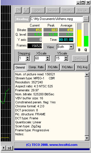

...which looks like this when I run it through biterate viewer...
... but the video stutters horribly when played. The audio is in sync though. I'm trying to find a way to make the motion more fluid.
