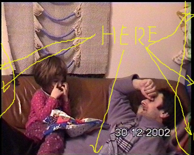

Here you have a sample of the signal I try to clean up.

Those "bad" areas around the edges of your video are completely normal for analogue sources (VHS, SVHS, 8mm, Hi-8, VHC-C).
When you create your DVD and watch it on a television they will not be visible as they fall within the overscan area of your tv.
If you watch your DVD on a computer then you will of course see it.
I would continue to capture the video using the Analog Pass Through feature of your miniDV camcorder - once the video is on your computer, you can use VirtualDub (or whatever you use to edit your video) to crop out the affected edges or replace them with a black border. -

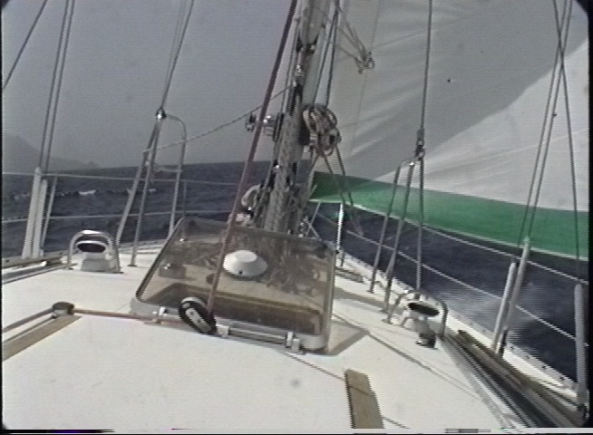

What you are seeing there is normal. Here is a capture from a 14 year old Hi8 tape ($3000 Hi8 camcorder). The black at the corners was caused by a UV filter and should be ignored. Normal TV sets mask the edges through overscan.
DV format captures to 720 horizontal pixels. Normal NTSC or PAL would scale to 704 pixels. The extra 8 pixels on each side are there to allow for horizontal position (phase) errors and are built into the format. The result is always black sides on an NTSC or PAL capture to 720. Capture to 704 would crop the picture if there was any horizontal position error.
