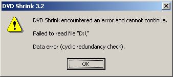

  1. I get the attached image when dvdshrink is analysing a dvd-9. i have an nec 3540 burner. any ideas? it runs the full analysis actually, then gives the error before it displays the dvd contents.

  3. Member Sifaga's Avatar
    Aug 2003
    Melbourne, Australia
    if the "D" drive is your drive (DVDROM or Burner) with the dvd in it, then its probably a dirty disc

  6. well it's not on the encryption list, but the error i'm getting is listed on that page. the thing is the page doesn't really say what the error is. i'm assuming their 'solutions' will help with it so i'm getting DVD Decrypter and reading through the rest of the suggestions.
    thanks!
  7. found this at the bottom of the page:
    "Cyclic redundancy check": make sure that the disc is clean (no fingerprints), and not physically damaged (scratches).
    there is a big scratch on the disk.
    duh.
  8. Mod Neophyte redwudz's Avatar
    USA
    Two options with damaged discs. Clean it with a mild soap and warm water. If it has a scratch, you may be able to polish it out with a mild abrasive. White tooth paste is one polish, or you can get a commercial type. Polish across the disc, not in circles. It may take time.
    DVDDecrypter has a mode to ignore errors, but you will lose that part of the errored data. ISOBuster is also good for this.
    If you choose to ignore errors, you will get unpredictable results depending on where on the disc the error is. If the error is in an IFO file for example, that's a BIG problem because that is a structural problem, which is a much bigger problem than missing a chunck of the video data --- Good luck with the disc polishing.

  12. Mod Neophyte redwudz's Avatar
    USA
    Here's a decent explanation of CRC errors. They can be from the media, the drives, or sometimes the software. It's basically comparing data from one source to the other to see if they match. Any interruption of the data stream or physical damage of the media can cause it.
    You could get a CRC error from a damaged DVD disc or a damaged or dirty DVD player, or in the case of an external drive, the OS or software interrupting the data stream. I should mention also that CRCs are an infamous cause of hard drives resetting to PIO mode. Something you may want to check if your drive seems slow.
