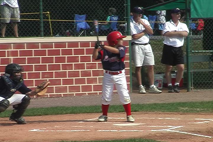

Download and play this short (10 frames) MiniDV file:
dvtest.avi
After you play it, extract Frame-2. It should look just like this:
If it doesn't, then you definately have codec issues like I said earlier.I stand up next a mountain and chop it down with the ledge of my hand........ I'm a Voodoo child.... Jimi Hendrix, -

Ok, i did what you asked, and the video looks great in my editor, and the captured frame looks perfect. So it doesn't look like a codec issue. I was hoping it was, so at least i had something to go on...Originally Posted by dipstick

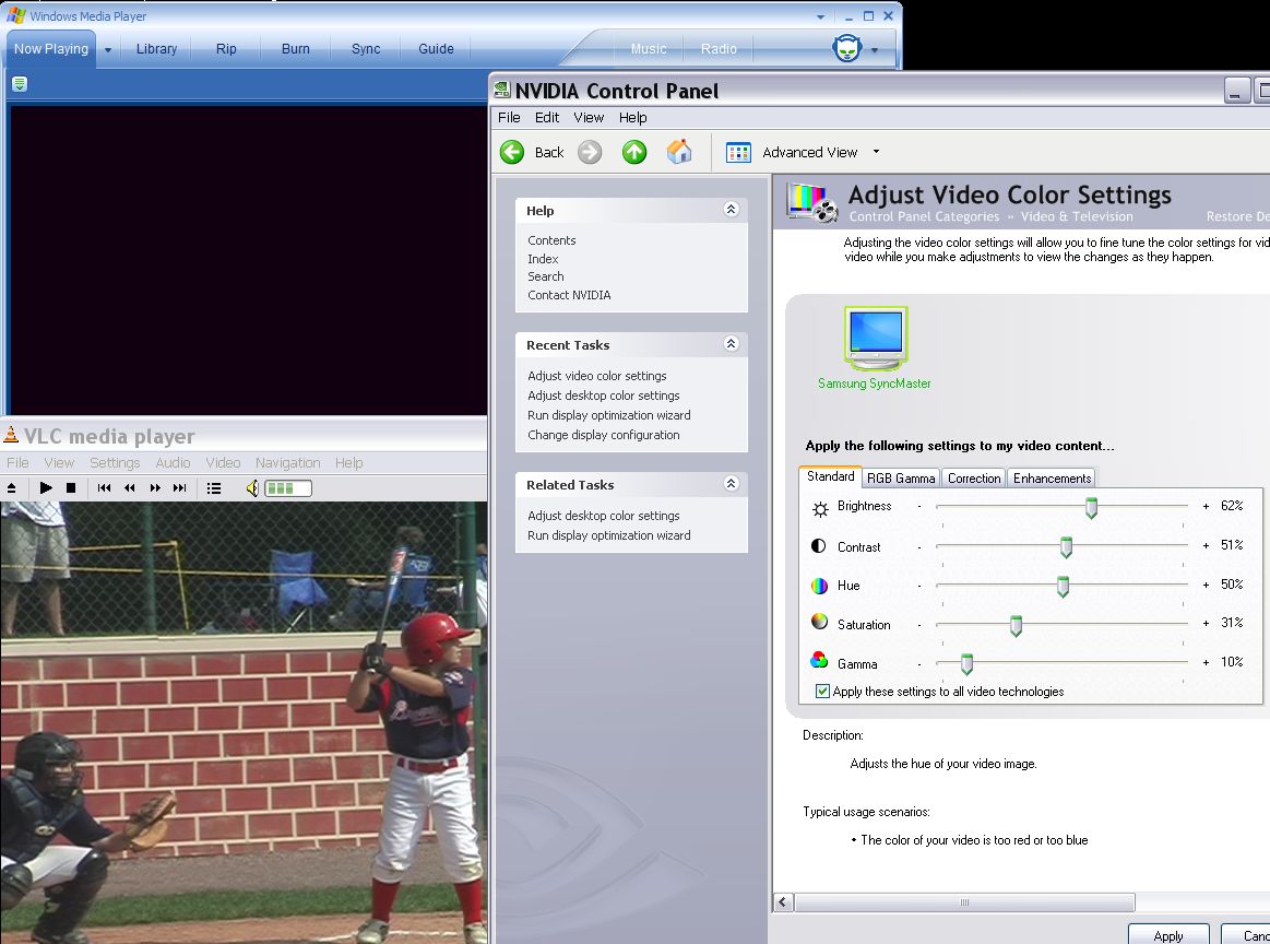

I switched to a desktop with a FX-5200. The NVidia control panel is under Contro; Panel, Display, Settings then Advanced.
Run the Optimiztion Wizard first. You will see seprate adjustments
- Adjust desktop color settings
- Adjust video color settings
VLC on my machine is running on the desktop so it responds to desktop settings.
WMP and PowerDVD are displaying the overlay and thus respond to "video" settings.
The overlay isn't showing in the screen cap.
