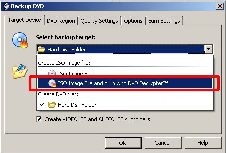

    how to i get DVDShrink to burn with DVDDecrypter or CopyToDVD?
    i turned off burning with nero, i even got the output on the harddrive, it worked and played fine. But i don't know how to burn it now
    To set it up automatically within DVDShrink:
    I believe that if you have CopyToDVD installed, it gives you a similar option.

    hmm, strange, when i click that, i only recieve the choice of Hard Disk Folder, or when i had Nero selected to burn, it only had that as a choice. ill look again
    edit: ok, it turns out my computer, for some reason, wasnt displaying any text in the drop down box, but, i figured it out, and set it to burn with dvd decrypter, and its encoding now, so hopefully it will burn
