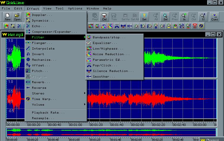

    anybody know where the Hiss Reduction Filter is located in GOLDWAVE ? as mentioned above, there apparently is one, but i cannot locate any Hiss filter. thanx
  14. Disco M, thansk for the recommendation.. but I already invested in a NAD 6325 at the recommendation of Davideck.. But I will look into DCC regardless.
    Does anyone have preference respects using Audacity vs. Goldwave for cassette to CD? Are they comparable apps?? Thank you.
    Edit: Also, p_l, I'm guessing Noise Reduction option in Goldwave = hiss filter, yes?? Thanks.

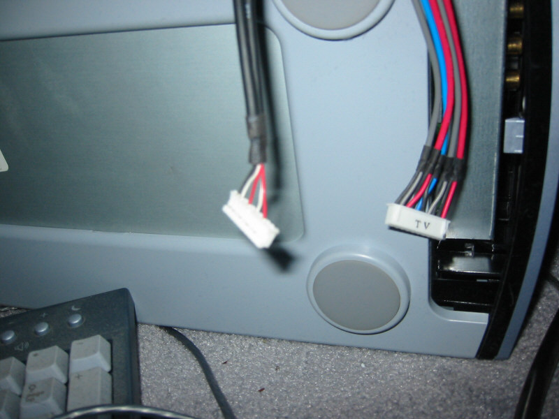

    2nd edit: Great.. no audio whatsoever from pc when I connect left and right audio FRONT ins from cassette player.. opened her up and found these two cables not connected anywhere (one is labeled TV and the other not labeled but I'm sure it's audio).. Problem is I don't know where on the mobo they connect to.. looked everywhere and .. ?? Here's pic of cables. Do I need a separate audio card--I thought they connected to onboard audio?? (I know I shouldn't be asking this question here, but thought I'd take a chance--thanks!)
