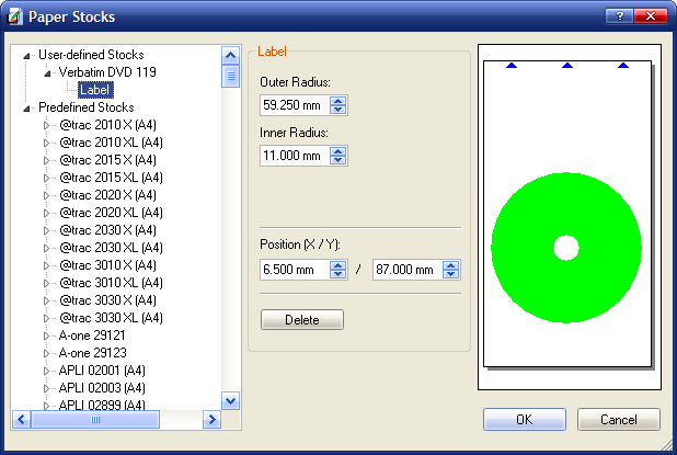

    No matter what i do i still can't get it to print w/o the white band, its off center its such a PITA. I am using a 119mm template that i got from one of these sites floating around, probably knightcrawler's and it still prints off center on a printable disc, i'm using nero cover designer. I have the tray and am using verbatim datalife plus printable hub 119mm
    Try editing the Outer Radius here to 59.500 mm. Since radius x 2 = diameter, that'll give you a diameter of exactly 119 mm. Keep adjusting it slightly if still necessary. You may also want to adjust the other parameters: the inner radius and/or the X/Y position.
