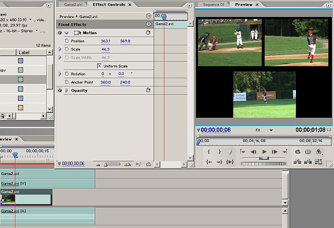

  10. Member dipstick's Avatar
    Jan 2005
    Dark side of the Moon
    You should be able to do it easy enough in Premiere Pro with no plugins or anything.
    1)Simply add a new Sequence. Call it Preview Sequence.
    2)In that Sequence, import all 3 video angles and sync them. You can Copy & Paste to make it easier.
    3)Resize them so that all can be viewed in the Preview Window at the same time.
    Now when you scrub the Preview Sequence, all camera angles will be viewed at the same time. Pick witch one you like and switch back to your main Sequence to edit.
    I stand up next a mountain and chop it down with the ledge of my hand........ I'm a Voodoo child.... Jimi Hendrix,
  11. Member dipstick's Avatar
    Jan 2005
    The layout ends up looking something like this:
    It's pretty easy to do, really. And you should be able to do it with other NLEs that support PIP.

    Thanks for all the replies. You've all just stopped me from spending a lot of money!
    The Avid demo looks horrendously complicated and I'm still not sure how I'd do what I want to do. It talks about stopping the playback and adjusting clip lengths. I don't want to stop, I wanted to do it while it's playing in real time. The other downside is nearly £400 and no demo available to try before I buy.
    The link to the Vegas tutorial was the most helpful. It shows how it can be done but not quite in the way I was thinking of, but done nonetheless. The same goes for the suggestion of doing it in Premiere Pro. Both these are using a similar method.
    Both the above methods don't run the three streams in separate windows but by overlaying the streams in the one window. I then realised that I can do just that with the software I already use!
    Apply Picture in Picture moving paths to the 3 streams and preview the video. MediaStudio Pro can preview in real time in a window on the computer monitor but also in full screen on a dual head device. As I always preview using a TV as a second full screen monitor, that doesn't matter and it works perfectly! MediaStudio Pro won't let me cut streams during preview, but it will let me insert a cue marker. All I then need to do is go back, remove the PiP moving path and cut at these markers.
    Thanks to all that replied, it seems I already had the software to do the job, I'd just not though of using it that way.
