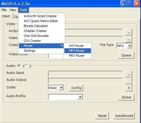

    According to hint given by Baldrick, I used MeGUI v0.2.2.5a to create an MP4 file. I opened the MP4 Muxer in the Tools option as shown below:
    I opted for an MP4 muxer, b'coz, I don't know abt AVISynth script - which is needed to create an MP4/AVI/MKV/RAW files in MeGUI v0.2.2.5.a:

    Now, what are these MPEG-4 video files. Do they have an extension called .mpeg-4, b'coz even AVI is an MPEG-4 video container file, but it isn't opening in the above case.
    Please tell me how do I create an MP4 file from an AVI(encoded using x264 codec) video file and an ac3 audio file

    Default setting when you load it up is mp4. All you really need to do is load the source, encode and you will get a 700k AVC mp4 encoded using x264.
