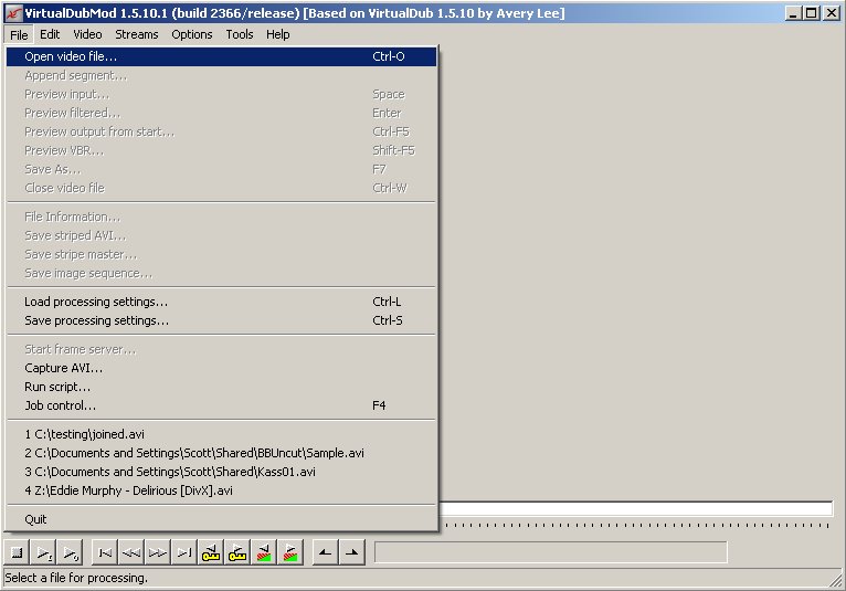

    Open Virtualdubmod:
    Go to File > Open Video:

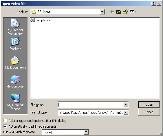

    Browse for your source file, and either double-click on it or click on it once and click the "Open" button:

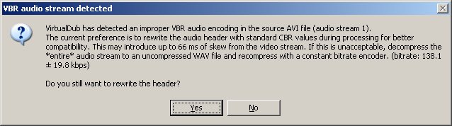

    If your source file has the dreaded VBR MP3 audio, you will get the following message:

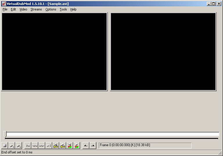

    Click the "No" button (if applicable). Your file will open:

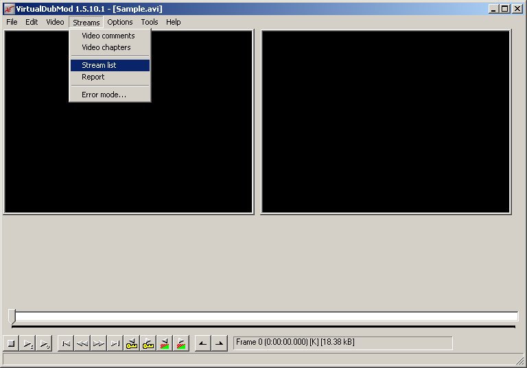

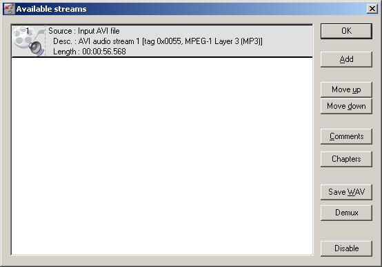

    Go to Streams > Stream List:

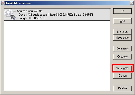

    This will display a list of available streams in your source file:

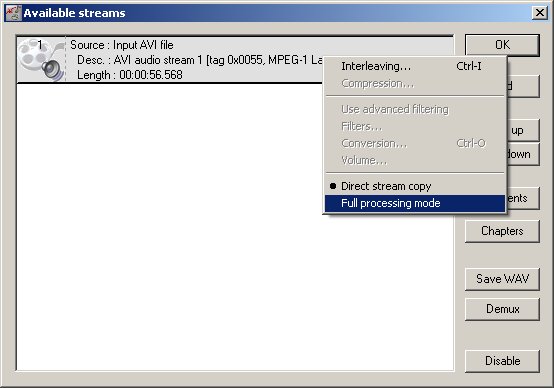

    Right-click on the stream you require and go to Full Processing mode:

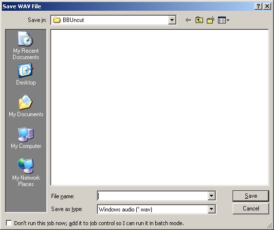

    Click the "Save WAV" button:
    Browse to where you wish to save the file, give it a name and click the "Save" button:

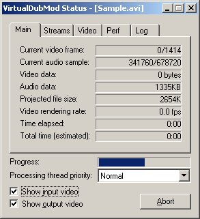

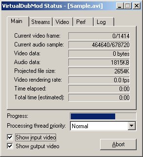

    The audio will now be extracted:

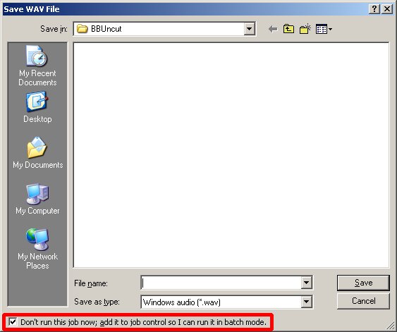

    If you wish to process multiple files, you can use the "Job Control" function by ticking the following box:

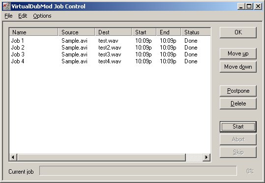

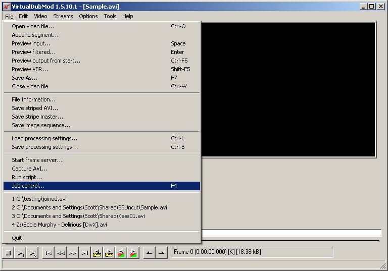

    Repeat as many times as necessary. When you are ready to commence processing, go to File > Job Control:

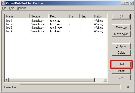

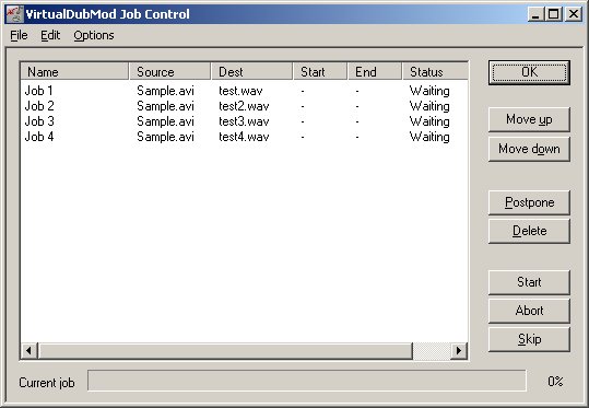

    This will display a list of jobs you've added:
    Click the "Start" button when you are ready to process:

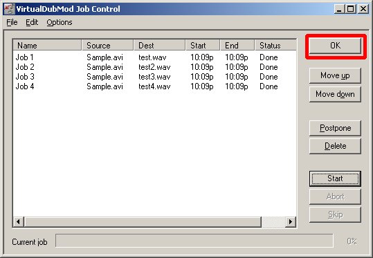

    On completion of all jobs, you will get the following screen:
    To exit Job Control, click the "OK" button:

  2. I recommend you enable audio Full Processing Mode so you get uncompressed PCM. Otherwise you'll end up with MP3 compressed audio (in your example) in a WAV container. You may also want to use the Conversion... option if the audio has unusual properties.
    I have actually tested it with Full Processing Mode and had that in the guide originally but it didn't work on my sample file properly (it truncated early), yet just going straight to "Save WAV" worked flawlessly. The source file might be buggered though. I'll put it back in the guide
