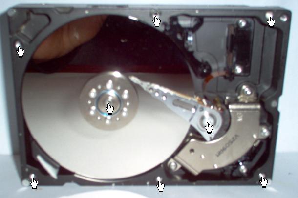

In this picture below , I have marked where the cover screws for the BB models cover are located with a hand cursor , note there is one under the unit label (smack bang in the middle) , and one under the round silver seal . So you will have 8 screws to remove first , before doing so , place the drive on a flat , clean surface .
You may after the removal of the screw's , need to use a small bladed screwdrive at each corner to assist in the removal of the cover , it should come off without any problem . Once loose , lift carefully straight up , then place it away to the side , with its screws .

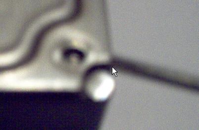

Look carefully and you will see the end of the armiture , and you'll notice a small metal tab , that sticks to this magnet .
You can use a small tool to gently push the metal tab to the left , just to break the magnetic hold .
Just under this location , is a small gap in the plasic guide , it is this area that metal tab will pass through so you can remove the magnetic lock from the drive .

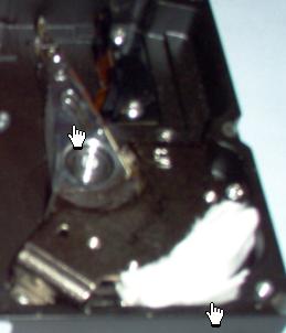

Gently push the the armiture to this position :
As you will notice , I am using a small wad of linen to keep the armiture in this position , to prevent it from swinging back over to the platters .

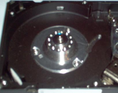

Next : Platter removal
You should now put your cotton glove on or rap the hand that will hold the platters from turning in linen cloth (lint free) , the other hand will be busy unscrewing these 6 screws .

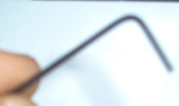

Now the tool I am using for the removal of the screws is a hex bit which fits nice an tight .
Removing the screws in a diagonal pattern , once a screw is completely free , you should grab it , lift it directly up , then away , do not let the screw's or the tool come into contact with the platters .
Do this for all screw's .
