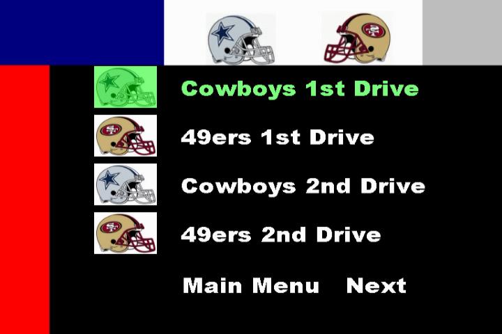

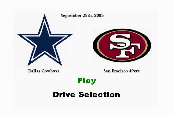

here are a few screen shots of my finished product.

Your finished product looks nice and very practical for following drives and watching defense vs offense.
