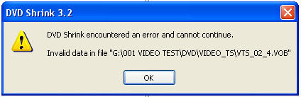

    ive tried : shrink, decrypter, fab decrypter, dvd43, anydvd, freedvd in several combos of each....bottomline cant open with dvd shrink. its the only one that gives an error.
    Invalid data in file"C:\DVD_VIDEO\VIDEO_TS\VTS_02_4.VOB"
    Overlapped I/O operation in progress.

    Yep, mine said the same thing, VTS_02_4.VOB was the problem.
    DVD Decrypter would not rip it in any mode.

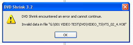

    DVD Shrink still would not open it!!! EVEN after getting it to rip with "DVDFab Decrypter" !!!!!

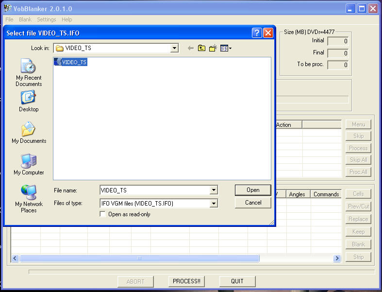

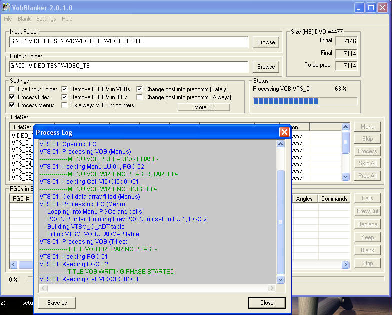

    Just for shits and giggles, i thought, well, i have it ripped to my HDD so why not try VobBlanker on those files. This time VobBlanker read them fine, and after running it through, DVD Shrink opened them fine!!
    This is what i got from DVD Shrink after ripping with DVDFabDecrypter

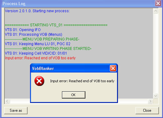

    This is what i got trying to open the disc with VobBlanker
    So even though DVDFab Decrypter did rip the disc, it still would not open in DVD Shrink until i ran it through VobBlanker.

    Yep, i opened the VIDEO_TS.IFO in the folder i ripped the disc to with DVDFab Decrypter, then made the output folder diff., then just ran it through VobBlanker, then all the files in the new folder opened perfectly in DVD Shrink

    Well, i know VobBlanker will not do it from the dvd, and even after ripping with DVDFab Decrypter 2.9.5.2 Beta2 on my 3rd COMPLETELY clean machine, i still got the error trying to open it in shrink. My buddie has it also and tried on his system and also got the same error until he ran it through VobBlanker.
