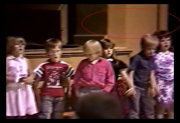

    Guys, got a bit of a problem here. Upon inspecting the captures that I have been doing, I noticed that on all of them, there are at least 2 bars/bands of color near the top running horizontally across the entire video field. They do not show up as much in blues and darker hues, but reds and "hot" colors show them more pronounced.
    Here is a sample (the area circled in red clearly shows the bands):
    I've tested my original source tapes on a different VCR and the problem disappears, so I know that this is showing up from my JVC SR-V101US. I am unsure what to do, or even what is causing this problem. I welcome any insight.
    Also, I have the mode set to Auto & TBC on.

    I see alternating red and green bands. Is that what you are talking about?
    Do you see them when viewing directly from the VCR to a TV or Monitor?
    Are they more noticeable when you turn the TBC/DNR off?
    Were these tapes recorded on the JVC SR-V101US, or on a different VCR (or a Camcorder)?
    They look like impact errors, but it's hard to say without knowing the answers to the above.

    davideck,
    To answer your questions:
    1. The 2 green bands are what I was referring to...but looking at it some more you may be right, there may be red lines alternating with them. I'll have to look some more.
    2. The lines show up when using this vcr connected directly to a TV.
    3. Turning off the JVC's TBC/DNR does nothing - banding still shows up.
    4. The tapes were recorded by camcorder, but I have tried other tapes. They all do the same thing...even movies.
    What do you think?

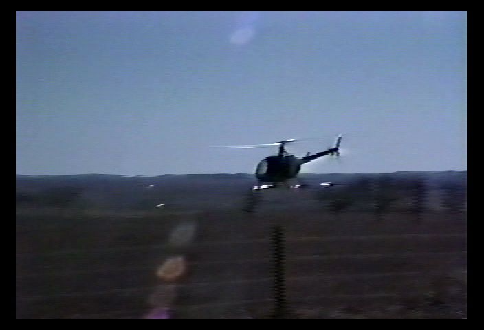

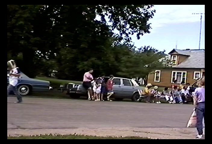

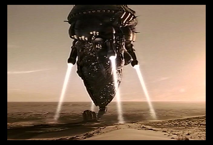

    Here are some more samples. First 2 are from home vhs caps, second 2 are from The 5th Element.
    Note how its hard to spot in the blue...
  6. Preservationist davideck's Avatar
    Feb 2003
    USA
    Wow! It's easier to notice on these new samples. Even the blue on the helicopter shot.

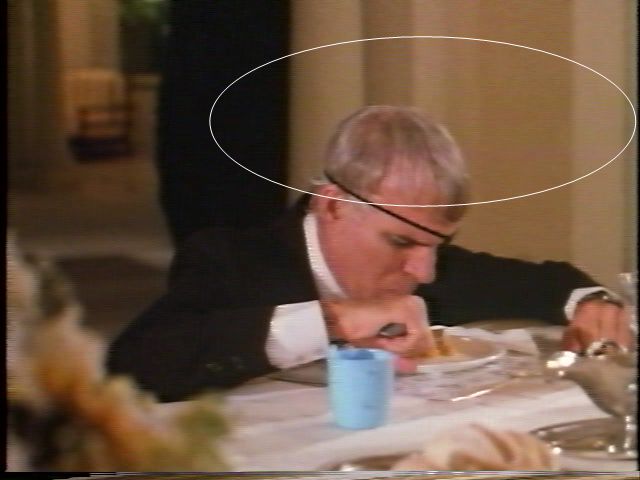

    Ok, here is a quick clip of the color banding
  28. Member
    Dec 2004
    NE, USA
    Ya know, I was hoping it was all in your head, but...sure enough...its there.
