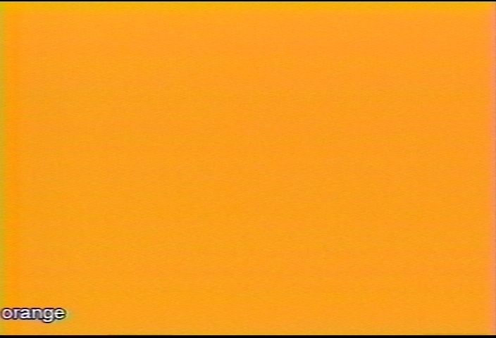

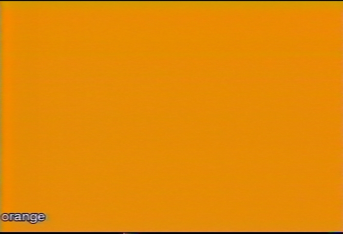

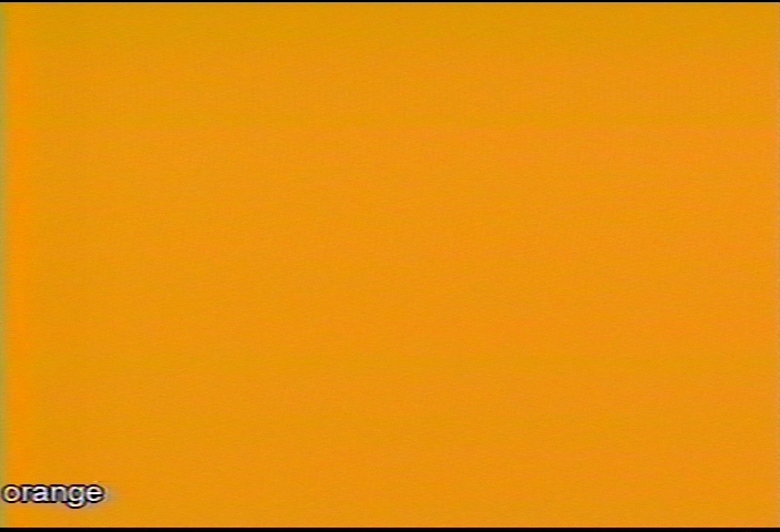

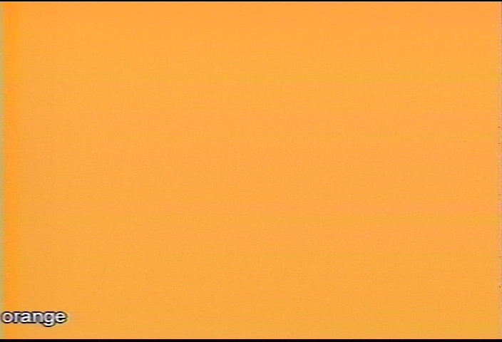

    Well, I'd liked to have seen these tests run with the SR-V101US as well as other VCRs, but I do think it's still worth looking further into. In that regard, here are some tests from some of my other VCRs.
    Toshiba M784 (composite)
    Panasonic PV-4662 (composite)
    JVC HR-S7600U (s-video)
    Mitsubishi HS-U781 (s-video) (the vcr used to record the test tape)
    I think I can see at least ~some~ banding in every one of them.
    @davideck - interesting theory. Perhaps born out by the evidence.

    Nice caps BrainStorm69. You're my personal hero for today. :P I definitely see some degree of banding in all VCRs. davideck's theory looks more and more plausible to me. The SR-V101US that I had defintitely showed these errors (or whatever it is they are) more strongly than my 9500u, which I swear I still can't see.
    The ultimate conclusion then is, how much of the banding can you take? If you can't take a lot then, then perhaps older JVCs are better than newer ones. But if you don't even notice it in your caps, then it really doesn't matter.
    The ONLY thing that I could see botching this experiment is whether or not the banding was actually recordered onto the test VCR you used to create the test tape.

    Looking at BrainStorm69's pics, I notice a thin green band about 20% down the frame on the first three VCRs. This suggests that this band is recorded on tape.
    This same band is less pronounced on the last VCR, the one that made the recording. This would be expected since the same impact profile on record and playback should tend to cancel the errors.
    Impact errors are timebase errors and might therefore be reduced by a good TBC. It would be interesting to see if anyone notices a difference through their TBC. I doubt that DataVideo units would make much difference. The 7600 pic (with internal TBC) does look to me to be the most uniform of the four, but some errors still remain. This could be the result of the frame based Chroma DNR reinforcing chroma shifts that are stationary from frame to frame.

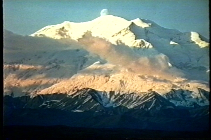

    Darn you guys! I thought this JVC (HR-A56U) did pretty good for a <$100 consumer machine, but nooo...You had to show me the green lines. The shot is of a slide show, transferred by Cam Corder.
    When you captured this image, were you playing back on the same machine that made the recording?
  23. Member olyteddy's Avatar
    Dec 2005
    No, IIRC it was recorded on a Sony S-VHS deck using my Sony Hi-8 camcorder as its source. It was about 12 years ago. The banding shows on most tapes. It doesn't really bother me, I was merely pointing out that once you see an artifact, you end up obsessing about it.
