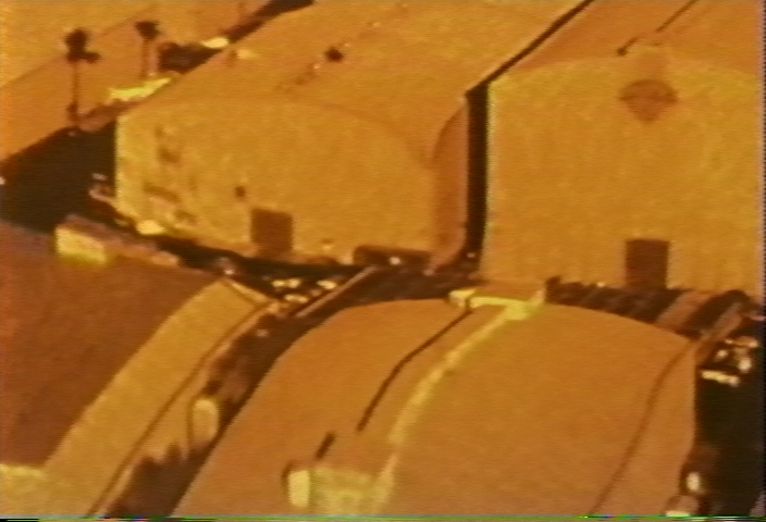

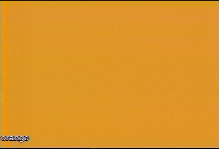

    OK, it looks like my JVC 9900 suffers from it somewhat, and the 9500 even less. I've never noticed it before, so I don't think it's too noticeable with a moving picture. But see for yourself.
    JVC 9900
    JVC 9500

    My screen caps above were from my DVD EZMaker, which completely ignores MV. And the cap was straight from the VCR to the card - nothing in between. But I did have the JVC TBC on. I wonder if that makes a difference? Might have to try some more caps, but too late tonight.

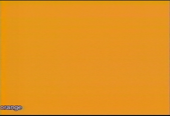

    Just for completeness' sake, here is the same cap from my JVC 7600. TBC "on" like the others.
    JVC 7600

    OK, since orange seems to be a color that shows this better than others (shows up as green), here is a cap from the 9900 and the 9500 30 frames into the solid orange background.
    9900
    9500
