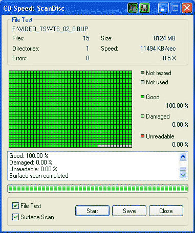

Well, finally, i got some relief
It was not only cheap price for BENQ DW1640 burner at www.Newegg.com, next day shipping from coast to coast, easy and trouble free installation, but also burning the rest of so called "bad media" Sony discs, getting "Data verification completed successfully!" and I hope playing without skips and freezes...
To be honest I did not try to play it yet!
Thanks to all ppl who did participate in help for me,

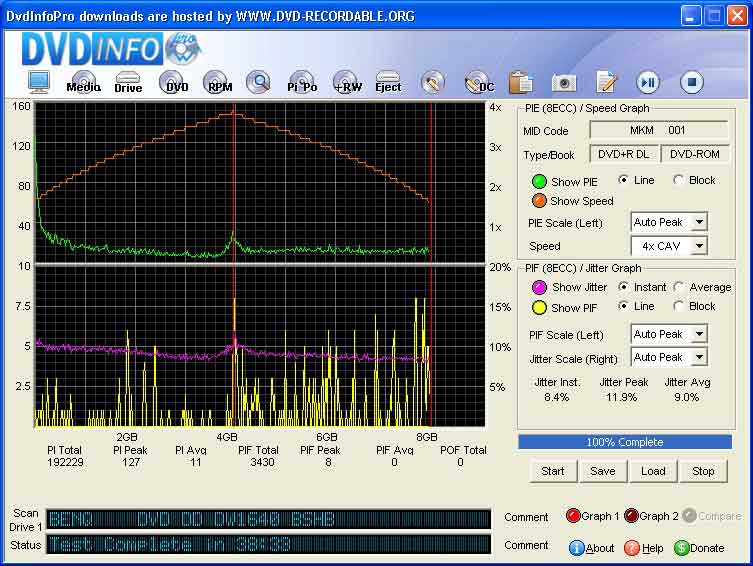

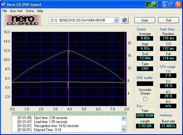

There are 2 DVD-5 (2 Series of same movie). I ripped main movies from each. Then using DVDShrink combined them and slightly (94.6%) shrunk to fit on DVD-9. But when I burned the disk, while watching I found out that in the middle (possibly right after switching the layers) on my stand-alone it started skipping badly.
I know that some players are slow at switching layers like it was explained to me here:
https://forum.videohelp.com/viewtopic.php?t=297077
but it was not THAT bad.
Then I inserted that disk into BenQ 1640 and scanned it with Nero CD-DVD Speed and DVDInfoPro:
I would really appreciate any input about this
TIA,
taboo -
You do have a small jump at the layer break, though it doesn't look too bad. Does the disc skip on your computer? It just might be your standalone player, some have a little bit of a hard time with burned DL discs. You might try burning your DL media at 2.4x if it happens again.
