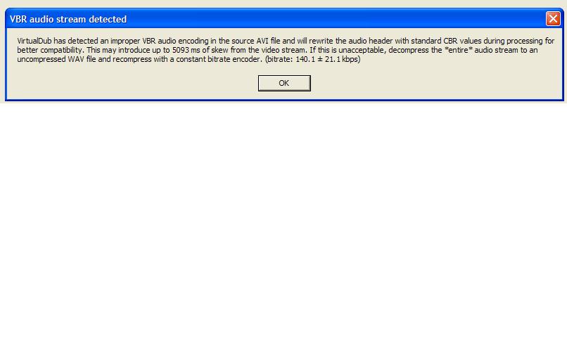

    Hi sorry for the constant postage but I keep finding things that I should of put in the previous post! Right I think I have found out why audio sync isnt in but not sure how to fix it, I dont know how to do what Vdub is telling me. Please looked at attatched image, thanks for the help so far

    If you set the audio to full processing you will get PCM.
