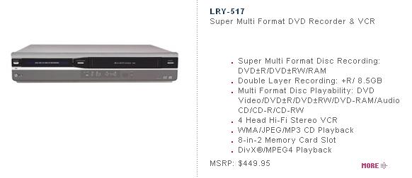

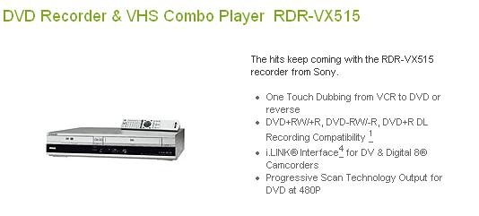

  9. There are new units coming out all the time but at the moment, these two units appear to be the only ones that satisfy all your requirements of 1) recording to dvd-r, 2) recording to DL, and 3) happens to be a combo.
