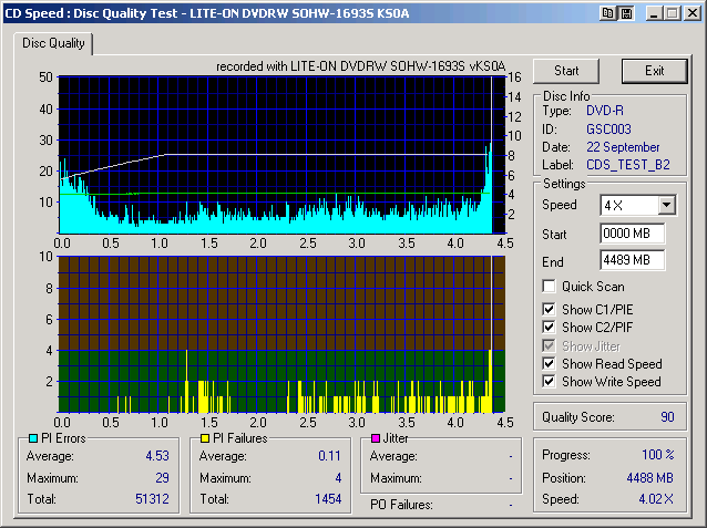

Good. Here's an image of Legacy 8x burned at 8x on a Lite-On 1693s as inspiration (not the same product, I know). It was a pleasant surprise for crap media.
-Evan- -
Wow, You just informed me that I'm a nubbie. I have no idea if that test came out good or bad. I've never run a test like that before. Should I pick up some software so I can run the same kind of test?
