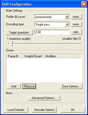

Use Xvid in single pass, quantization mode, with Target Quantizer set to 2. At least do it as a test to see what the best you can expect will look like. The bitrate will probably turn out much higher than you want so also try Q=3, 4, and 5.
