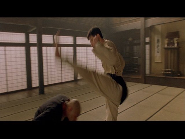

  1. These images are from an action sequence from "The Matrix". It compares the original, the ES35V and the ES10 encodes.
    The original,
    ES35V XP mode
    ES35V SP mode
    ES35V LP mode
    This is the ES10 LP mode for comparision
    There are about the same number of macroblocks in both the LP encodes but do the they seem more subtle, for example, in Morpheus's head with the new encoder?

    These tests are of an action sequence from "The Matrix". The files are vob's ( which can be renamed mpg for viewing with Windows Media Player ).
    The original
    matrixorig1sec.vob
    Still scene from the original
    The straight SP capture
    spmatrix.vob
    Still scene from the SP capture
    The XP plus to SP re-encoded capture
    xpplusspmatrix.vob
    Still scene from the XP plus to SP re-encoded capture

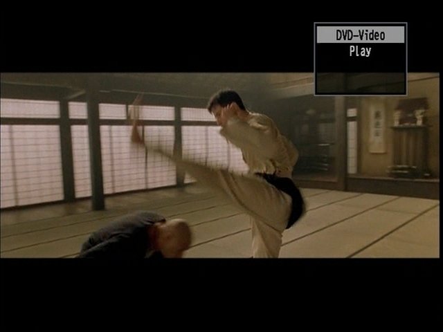

    I do not see much improvement in blocks between straight SP and XP plus to SP. There are blocks left of Morpheus's ear, a 3x3 pattern of blocks to the right of Neo's knee of his extended leg and a horizontal pattern above his belt.
    Strange that the captures look stretched compared to the original. All stills were resized to 640 by 480.
    These pictures/screenshots ... are these coming from a Pioneer DVD Recorder ??
    The small box up in the upper left corner ... I see that type of box in the Panasonic EH50 w/100 GB Hard Drive.
    I don't have none of the Pioneers models ... DVR-531H-s DVR-533H-s DVR-633H-s
    My Pioneer DVR-220 doesn't display that type of info
    Update ... after posting ... Sorry ... I posted too soon ... I looked at the page before and I see what is happening ... I'm seeing pix of the ... ES30V
    Moderators ... if you want to save bandwidth ... go for it ... delete this post ...

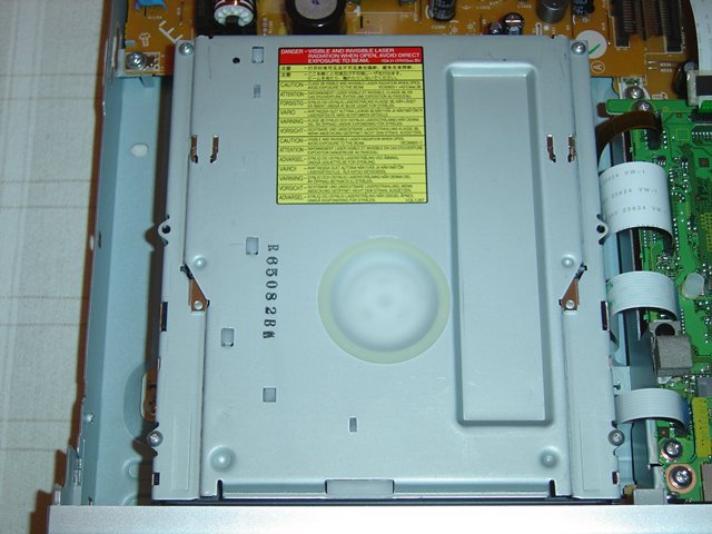

  14. Photos of the RCA DRC8030N
    Front view
    Rear view
    Top overview,
    Power supply
    Seagate Caviar 80 GB hdd
    Samsung tuner
    Smartpro International dvd-drive
    Zoran mpeg processor. I did not measure its temperature but with no heatsink it must be relatively cool
    Bottom view. The fan is small but there are a good number of vent holes.

    The original Matrix file,
    matrixorig1sec.vob
    XP mode capture direct to dvd,
    xpmatrixfastdvd.vob
    SP mode capture direct to dvd,
    spmatrixfastdvd.vob
    LP mode capture direct to dvd,
    lpmatrixfastdvd.vob
    XP mode capture to hdd then to dvd,
    xpmatrixfasthdd.vob
    SP mode capture to hdd then to dvd.
    spmatrixfasthdd.vob
    LP mode capture to hdd then to dvd,
    lpmatrixfasthdd.vob
  16. Panasonic DMR-EH55S photos
    Front with SD slot open and front panel input door closed
    Front with SD slot closed and front panel input door open
    Rear panel
    Top view with cover off
    Hard drive
    Mpeg encoder board. The encoder is under the aluminum heatsink in the center.
    DVD drive
    Power supply
    TV tuner
    TV tuner close up
    Rear panel detail 1
    Rear panel detail 2
    Rear panel detail 3

  20. These are tests of the LG RC797T combo unit. Composite output from the source was used instead of S-video since the RC797T has no S-video inputs.
    Below is a link to the manufacturer's description.
    http://us.lge.com/products/model/detail/tv|audio|video_digital%20video__RC797T.jhtml
    Source: Panasonic ES35V recorder with DNR set to off. IRE set for 7.5.
    Test patterns: THX test patterns from the ICE AGE disk
    Software: VirtualDubMod for PNY format images converted to JPG at 85% quality setting.
    Original THX contrast image
    RC797T contrast XP mode
    RC797T contrast SP mode
    RC797T contrast LP mode, resized from 352 by 480
    Original THX black level image
    RC797T black level XP mode
    RC797T black level SP mode
    RC797T black level LP mode, resized from 352 by 480
    Original THX color bar image
    RC797T color bar XP mode
    RC797T color bar SP mode
    RC797T color bar LP mode, resized from 352 by 480
    Original THX image from clip
    RC797T clip image XP mode
    RC797T clip image SP mode
    RC797T clip image LP mode, resized from 352 by 480
