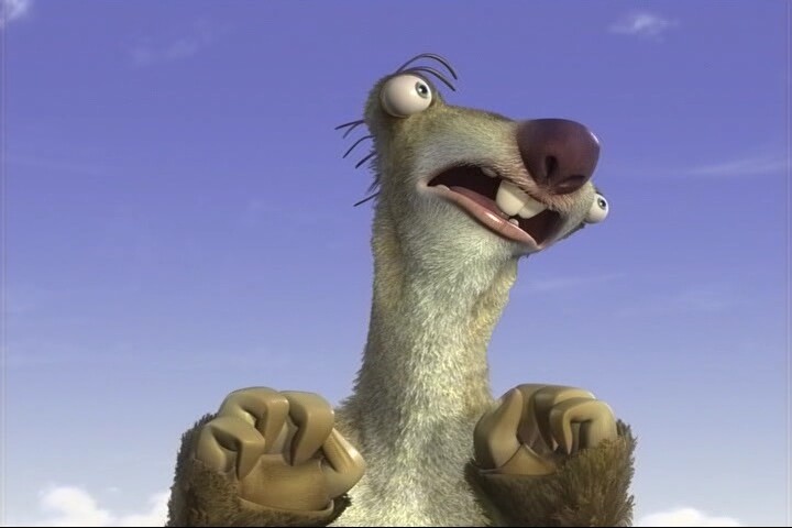

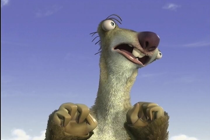

Here's how the Pioneer DVR-320 does recording with the DV input (I used a Pioneer DVR-520H as the source player, DV out)... definitely much sharper and more detailed than the 531/533. I would expect the DVR-520H to perform the same way, since it is basically a 320 with a hard drive.

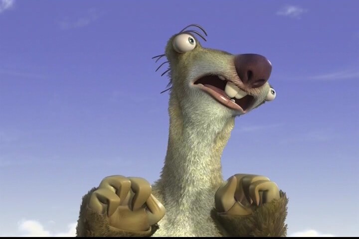

I do see a bit of faint edge ghosting in the "Sid" frame. I've seen this before with Pioneer 10 and 20 series recorders. Not a big deal, but the LSI encoder chip based machines (JVC, Lite-On) do not have this artifact.

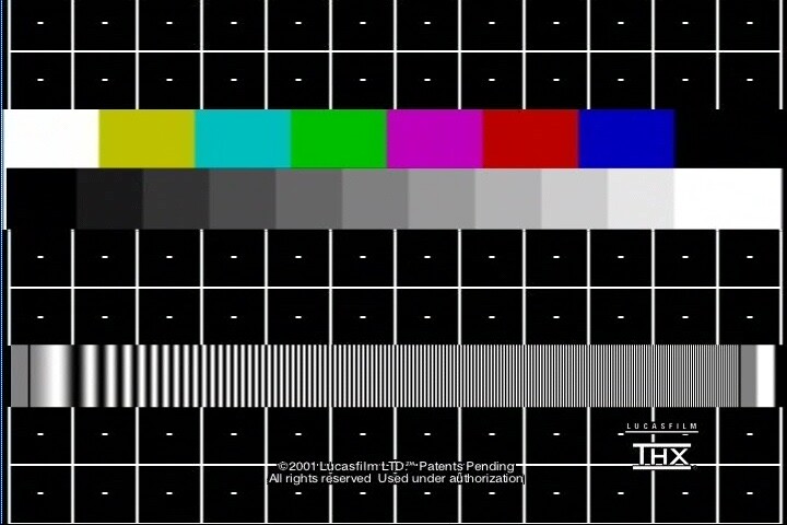

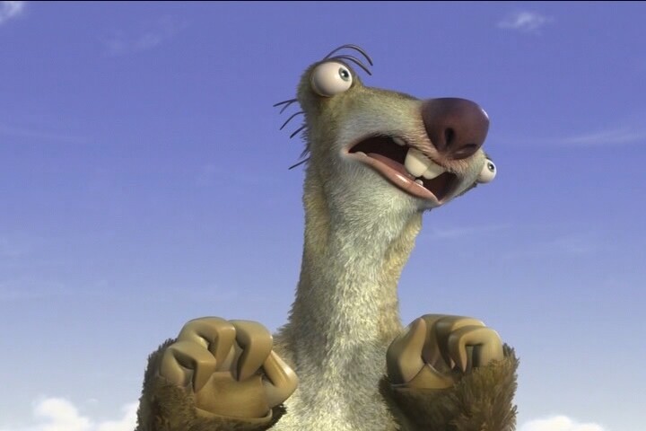

And here are the original THX test disc frames...
THX test disc, multi-purpose pattern:
THX test disc, Ice Age clip, "Sid":
It appears to me that the JVC still does a better job with DV to DVD conversion than the Sony. The Sony SP encodes have artifacts around some of the edges. The JVC encode looks closer to the original, with very few artifacts. However, the Sony HQ+ to SP "two-pass" encodes look real good. I'll have to do some high motion sequence testing using that method to see how they turn out. -

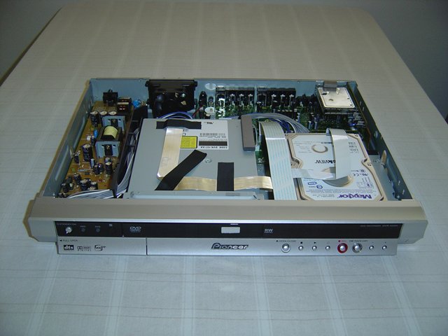

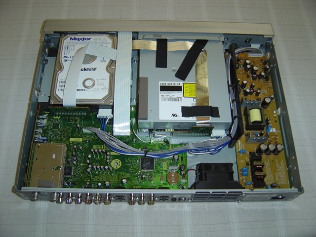

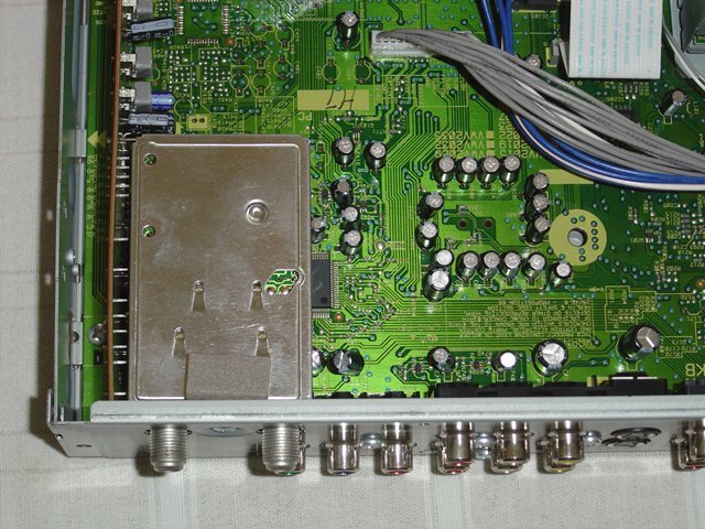

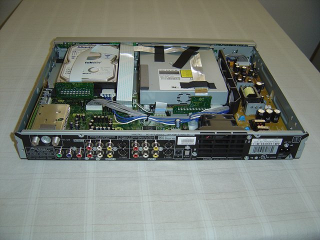

Here are some photos inside the Pioneer DVR-420.

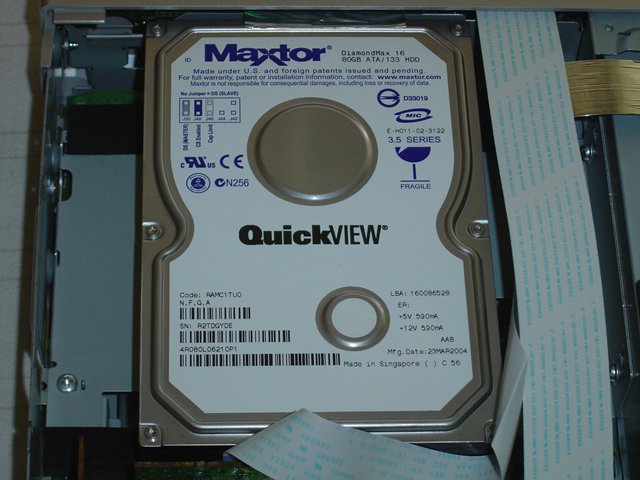

The hard drive
The tuner

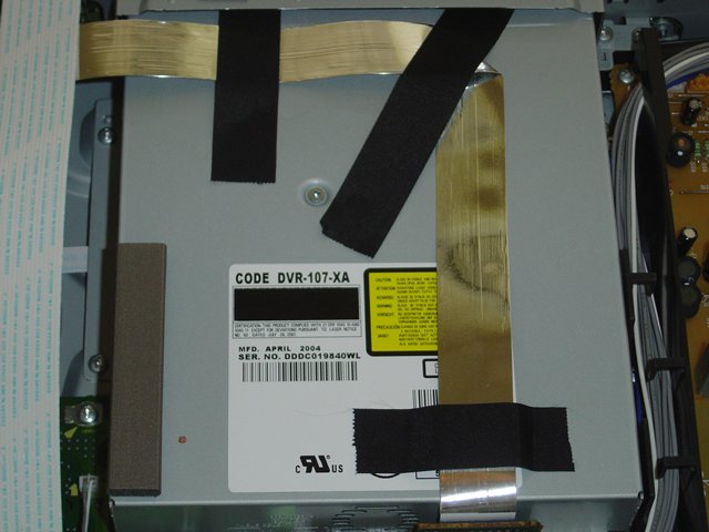

The dvd drive

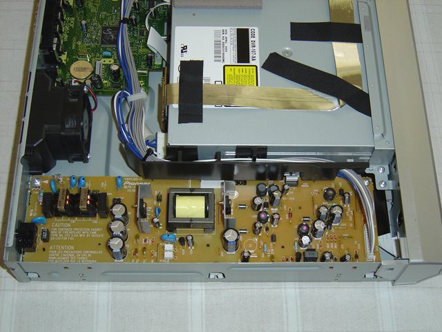

The power supply
Underneath the hard drive

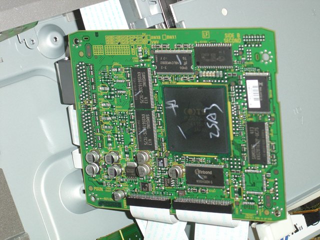

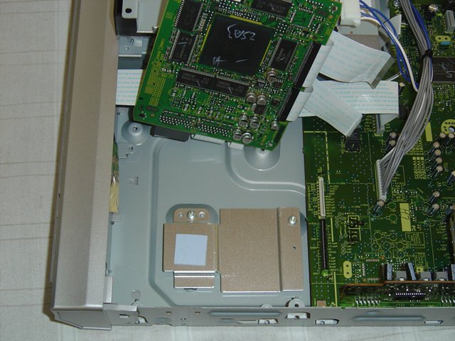

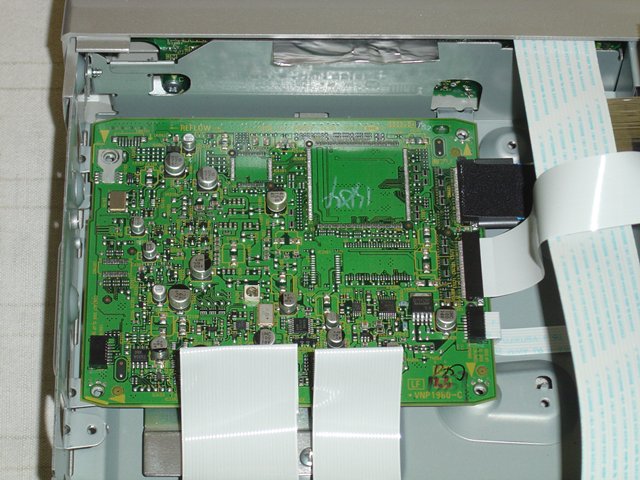

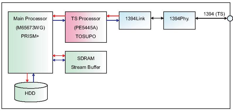

The encoder chip. Anyone recognize it? The numbers are line 1) M65673WG, line 2) 41109. The logo is followed by capital TS.
The heatsink for the encoder chip. The little square on the shiny metal heat sink is a thermal pad similar to that used in JVC M10's.
Rear panel
do u think adding Thermal paste like Arctic Silver 5 to the heatsink will help?
http://www.newegg.com/Product/Product.asp?Item=N82E16835100007 -
If you go the this Microsoft link, it has a list of "platforms" (read "chips") to which Windows Media Technologies (WMA, WMV) have been ported. The M65673WG shows up as a Mitsubishi Electric device.Originally Posted by trhouse
http://wmlicense.smdisp.net/ic_approved/ -

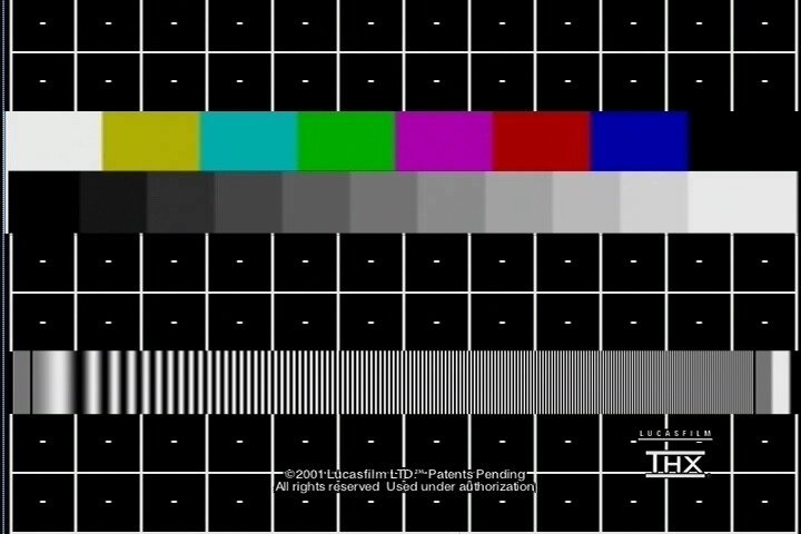

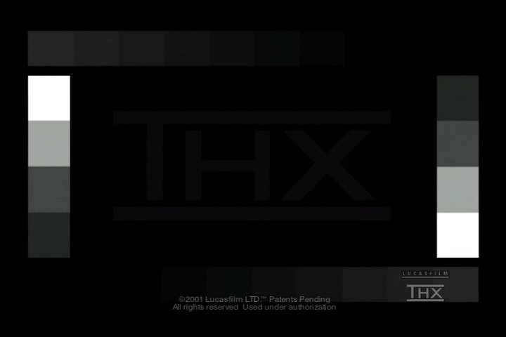

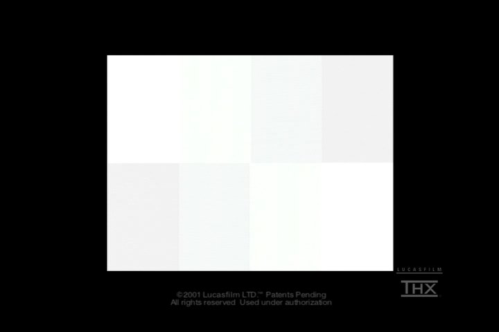

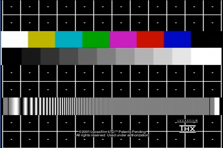

These tests were done as follows,
Test patterns: THX file from "ICE AGE" video.
Source player: Panasonic S35 dvd player
RDR GX315 connections and settings: The S-35 composite output was sent to the GX315 L1 composite input with video default settings.
The GX315 has output playback black level adjustment but no input adjustment.
Note: This post has been updated. The original post had the Panasonic S35 output IRE set to 7.5. The images produced looked too light. The current images below were retaken with the S35 output IRE set to 0. The black level tests show captures with the source set for both IRE=0 and 7.5 for reference.
GX315 contrast HQ mode ( equivalent to XP )
GX315 contrast SP mode
GX315 contrast LP mode ( LP mode has been resized to 720 by 480 )
GX315 black level HQ mode, IRE=0
GX315 black level HQ mode, IRE=7.5
GX315 black level SP mode, IRE=0
GX315 black level SP mode, IRE=7.5
GX315 black level LP mode, IRE=0 ( LP mode has been resized to 720 by 480 )
GX315 black level LP mode, IRE=7.5 ( LP mode has been resized to 720 by 480 )
GX315 multipurpose test pattern HQ mode
GX315 multipurpose test pattern SP mode
GX315 multipurpose test pattern LP mode ( LP mode has been resized to 720 by 480 )

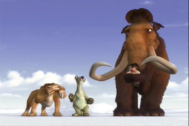

GX315 ICE AGE test clip HQ mode
GX315 ICE AGE test clip SP mode
GX315 ICE AGE test clip LP mode ( LP mode has been resized to 720 by 480 )
A few problems were encountered doing these tests. The GX315 does not like dvd-rw's that have been formatted by the computer. It would not accept such a disk and would eject it with the message "The disc can be neither played nor recorded". The disk would work if it is first formatted on the Panasonic ES10 in video mode. The Sony will still display the above message but this time it will not eject it. It can then be formatted on the Sony.
Also noticed that there are some strange blank areas at the top and sides of the captures. They are visible in playback in PowerDVD as well as VirtualDubMod. At first it was attributed to using a Panasonic ES30V for playback but then I switched to the S35 with the same result. These are most noticeable in the images of the cartoon characters.
The Sony does not have flexible record modes or chasing playback.

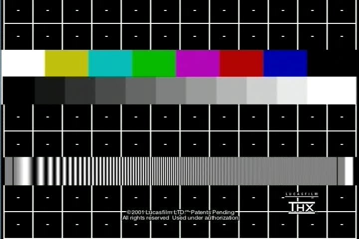

Panasonic DMR ES35V tests.
Source media: ICE AGE dvd
Source player: Panasonic DMR ES30V with s-video to ES35V IN1
Images are updated with ES30V mpeg DNR off and ES35V line in NR off
ES35V contrast XP mode
ES35V contrast SP mode
ES35V contrast LP mode ( still full D1, 720 by 480 )
ES35V black level XP mode
ES35V black level SP mode
ES35V black level LP mode
ES35V XP mode multipurpose test pattern
ES35V SP mode multipurpose test pattern
ES35V LP mode multipurpose test pattern
ES35V ICE AGE test clip XP mode
ES35V ICE AGE test clip SP mode
ES35V ICE AGE test clip LP mode

If the ES35 encodes at 720x480, it must be a new Panasonic chip (or maybe a re-branded LSI chip?).
It looks like the ES35's Line-In NR (and/or the ES30's playback MPEG DNR) was left on for those caps, too. -
You are right. I will repost with both off. Rebranding is always possible. Does the ES20 chip look the same as this one?
