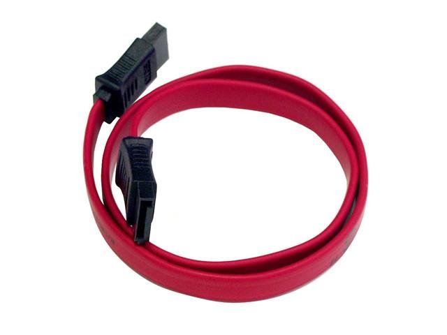

Also another question. are the IDE cable different then what SATA drives are going to accept?

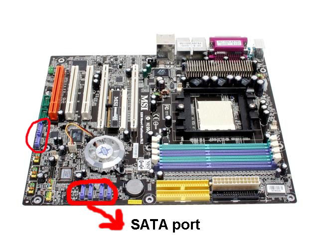

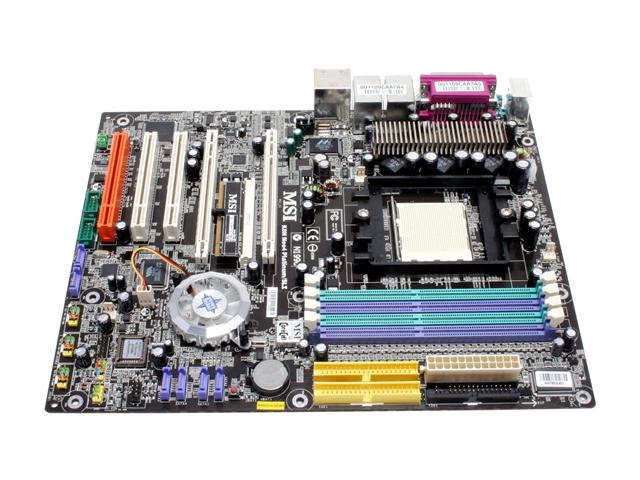

Where on this mobo would the SATA cable go?
MSI K8N Neo4 Platinum SLI Socket 939 NVIDIA nForce4 SLI ATX AMD Motherboard
Model #: K8N Neo4 Platinum/SL -
http://www.newegg.com/Product/Product.asp?Item=N82E16813130491#DetailSpecs

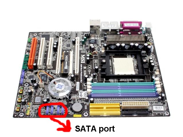

this one? if it is then the SATA ports here:
Originally Posted by gooberguy
it's ok the sata ports are the same on both mobo's.
