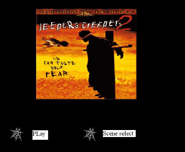

    I dont actually have the menu I was using on my computer anymore so I just made a little makeshift one in paint from images on my computer. The Below picture is not actually a menu, nor was the menu I made for Jeepers Creepers, it was actually for a rally racing DVD I was making from legally downloaded rally racing clips anyways, here it is:
    This is the basic structure my menu had. The two spiderwebs were the buttons leading to the movie (play) or the scene selection menu (scene select). The text themselves had no hotspots or anything. Where the jeepers creepers picture is, was a motion clip from one of the car races. The switched menu that I had was first when you put the DVD in the player, was with the spiderweb showing only next to the text "play" The button next to scene selection was invisible normal and had an auto action leading to the second switched menu. On this menu I had the jeepers creepers as a different clip, and the spiderweb was visible next to the text scene select. The play button was invisiable normal, with an auto action back to the first switched menu. What I wanted to have originally was to have the jeepers creepers be one clip which would play continuously while you switch back and forth from "play" to "scene select" and as you switched the spider web would be your guide as to which one you were selecting based on if you could see the web or not. I think your idea will help me accomplish this so that the clip wont be inturrupted by a switched menu. I hope this helps and that I didnt confuse anyone. If i did let me know and I will try to clarify better.

    Ooohhh, I thought it was more complicated than that.
    So you have the SAME video clip on both menus. Then yes, putting everything back on the same menu would stop the motion restart.
    I thought you had different videos which you wanted to play, and wanted them to not restart between switches, just picking up at whatever point was left off. (Which you could also do if you were so inclined by masking out the unwanted video using the same process as the spiderwebs.)
    Anyway, it looks like you got things in hand now. Happy burning.
