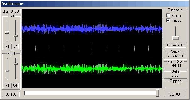

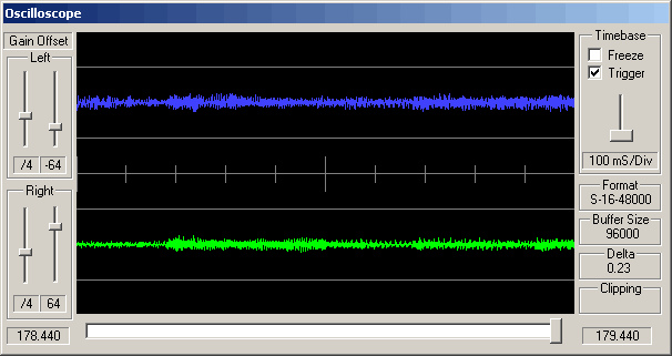

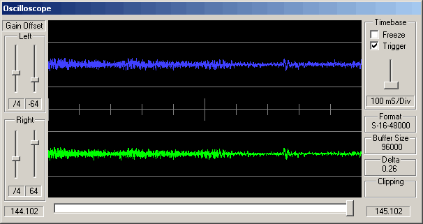

Oscilloscope Results from Different Channels/Recorded with Pioneer DVD Recorder/Non Recorded
Here is Fox News.. seems it's dual mono (this was not recorded just captured via digital audio input to pc)
This is VH1 also not recorded by DVD Recorder just streamed via Digital audio input to pc. (obviously different data on each channel = stereo)
This is VH1 but his time was recorded by DVD Recorder that used Dual Mono (obviously different data on each channel = stereo)... What gives? Even though I had the message "will conform to dual mono", it appears as stereo.
So what is up with this... Obviously Fox News has identical channels... Obviously VH1 doesn't, even when recorded in "dual mono" (last capture). If "dual mono" could it be that some circuitry is making it "pseudo-stereo" which changes one of the channels a bit? Does dual mono mean that both channels are identical, because obviously, the bottom capture was dual mono, but it appears as stereo... any answers?

Apparently you are not familiar with the MTS broadcast in the US. The current MTS (Multichannel Television System) broadcast actually carries a stereo audio track plus a third audio channel called SAP (Second Audio Program). On most TVs, it can be switched between Main (Stereo audio channel) and SAP (mono audio channel) if SAP is also broadcast. For example, the "George Lopez Show" on ABC does have an SAP track for Spanish, and the Main is regular English track in stereo. So there are in effect three channels of audio track broadcast over the air in the US although very few TV programs actually use the SAP audio channel.Originally Posted by thomseye
Since standalone DVD recorders could only record two-channel audio track, the VR mode recording (except XP mode) allows recording main on the left channel and SAP on the right channel, and it is called "dual mono" mode since these two are independent sound tracks. In Video mode (and XP VR mode), it can only record either main or SAP channel, but not both.
The NICAM system used in Europe is different from the MTS, but is also able to include two (or even three mono) language tracks as donpedro mentioned in his post.
If you already set External Audio at "Stereo", then Dual Mono Rec option is not even active, and there is no "dual mono", only "mono" or "stereo" input/recording, period.
As your "evidence" clearly demonstrated that some cable channels do provide stereo audio and could be recorded in stereo by your recorder, so go complain to your cable provider and not Pioneer. Those Pioneer's CSRs don't know anything about the products because they are from some outsourced call centers reading the pre-written script. If it's anything not on the script, they just make things up as they go along.
If the above quote indeed came from Pioneer's CSR, all I can say is that they definitely need to improve their reading comprehension on the manual."you can not record stereo on this unit via the line inputs unless you are using vr mode except xp mode.. recording in video mode will be recorded in dual mono. this only applies to line inputs, not the tuner".
