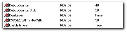

What do you have for the following keys in HKEY_CURRENT_USER\Software\Badger I.T.\SVCD2DVD 2.0 in the registry?
Can you change the EnableTimers setting to False to see if that makes a difference?SVCD2DVD v2.5, AVI/MPEG/HDTV/AviSynth/h264->DVD, PAL->NTSC conversion.
that key did not exist in registry so I had to add it
made no difference whether value was set to true or false
No I don't have a hourglass, normal mouse arrow appears almost immediately after program is opened. -
What about the debug counters?
Can you rezise the application window?SVCD2DVD v2.5, AVI/MPEG/HDTV/AviSynth/h264->DVD, PAL->NTSC conversion.
debug counters were there wih same values as yours postedOriginally Posted by ChrissyBoy

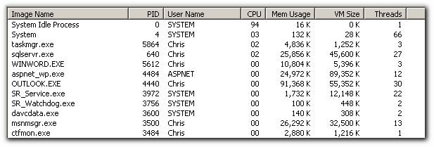

ok. What is the task manager showing? Is a single process hogging the CPU?
hhmm, 100% cpu usage with no programs running which is kinda weird. Maybe have some other stuff going on that i didn't know about, lemme check wtf is going on elsewhere
What about processes?:
thanks for ya help, seems problem was my end after all.
had a services.exe running 100% cpu all the time
now i sorted that problem out, the proggie runs sweet
fingers crossed i can get on and sort all these svcd's out now
Once again, thanks for your help -
How did you sort it out?
I used various tools to list process to files trying to find the rogue services.exe. After this, i booted in safe mode and deleted the rogue file. Cleaned up registry for instances of the file.Originally Posted by ChrissyBoy
This was after about 3 hours of reading various web sites, a google for services.exe @ 100% gives a large amount of replies!
I'm now running at approx 2% cpu usage and everything appears to be working okay.
