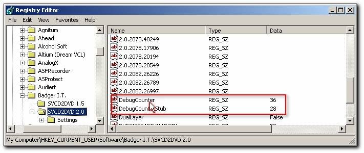

can you tell me the values you have for the following two keys in your registry:
I had the same problem as 'no hope' and used 'stedlj' solution to get it to work, so try that 'no hope and see if that works.
By the way I have the same reg keys as you with the same figures in them.
