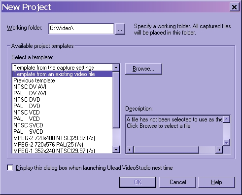

You should be able to rearrange and cut at will without any loss in quality. In fact, DV-AVI is an excellent format to edit with full transitions and effects. What template did you use to create your project? I suggest that you start a new project, select Template From Existing Video, then browse to the video you want to use. This will create a template in the same format as your source file, and smart-render should work well. If you do add transitions/effects/titles then only the sections where these things take place will need to be rendered (which is where the "smart" part comes in.) Then when you have the video to your liking select "Create Video File - same as project settings. This should leave you with a new AVI file of your edited video with the same quality as your original."Shut up Wesley!" -- Captain Jean-Luc Picard

Where's this setting? I don't see it.Originally Posted by gadgetguy

I have VS6 so it might be a little different, but on the Start tab click New Project. This will open the New Project dialog window which should have an option "Template From An Existing Video File". Select that and browse to the file you want to use for a template.

Originally, it was a more generic question about Re-encoding. When it got to the more specific, I read Ulead and my mind kind of blended the products together as being similar, assuming that Smart-render means the same thing in both products from the same manufacturer. I know that in VS6 the best way to utilyze the smart render feature is to start by making a template based on the file you are going to use because any difference between the template and the file will cause VS6 to re-render the whole thing, so I made the recommendation. I stated that I use VS6 in case MSP7 is different.

Exactly...that option doesn't exist on that screen in msp7...just seemed like a good way to, like you said, create the template.
