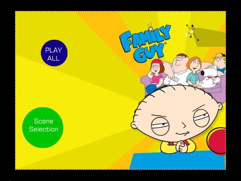

    Hey guys im new to this forum. Im using Ulead DVDWS2. im trying to put a pic on the main menu or watsoever as a background then burn it to DVD. When I play the DVD the menu looks uneven I mean the picture is cropped not displayed as it suppose to be its even kinda tilted it looks awful. does anybody has any idea how to make the pic display accuratley. By the way it display fine when I play it on my PC but on regular TV thats a problem!!!

    Try cropping your background picture down before you pull it into the menu. In other words size down the picture. There is what is called a safe zone for text and for the overall viewable picture that the TV can display.

    It could be that your picture tube is not quite level - much more likely than dvdws2 putting your menu on an angle

    yeah I did that, I made my picture same saiz e of teh safe area(the dotted triangle) and I used photohop and placed black bars behind the safe area like this one
    But when it displays on TV iy looks fit but kinda tilted in an angle for some reasong I can see a portion of teh black bars at top and bottom
