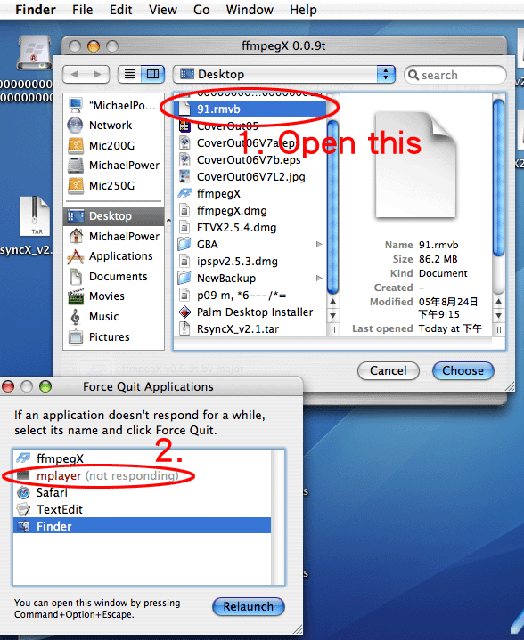

  1. I have an rmvb file. I try to convert it to avi or other, but it instantly jumps to "successful" and create a file. But the file is not working! why?
