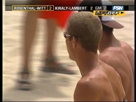

Something like the difference between this:Originally Posted by steve_r
and this:
jimmalenko it doesn''t have to be 448X336 can you suggest another size between 720X480 and 352X240 that might work well?
Junkmalle yep that is exactly it except the 352X240 is much better than yours there.thanks

If I'm not mistaken the 352 x 240 is deinterlaced, and the 448 x 336 is interlaced. View the 448 x 336 with software the deinterlaces properly like PowerDVD and I'm sure you'll find much ado about nothing. As for a frame size to recommend, why not stick the Full F1 (720 x 480) ?
If in doubt, Google it. -
Top frame has a blend de-interlace.
It isn't clear what you want to do with this 448x336 video. If it is intended for an interlaced DVD, that looks good to me. Author it, burn it, play it to a TV.
If you want it deinterlaced for some purpose, then deinterlace it.Recommends: Kiva.org - Loans that change lives.
http://www.kiva.org/about -
Both of the images were made with TMPGEnc without telling it the source was interlaced. So yes, the top image is essentially blend deinterlaced because every scanline is now the average of pairs of scanelines. The bottom image isn't really interlaced anymore, it's an incorrectly resized interlaced image.
Steve_r -- I doubt you'll find any player that will play a 448x336 interlaced video properly. So if you want to use that size you'll need to deinterlace.
On TMPGEnc's Settings dialog, go to the Advanced tab. Make sure the Video Source Type is set to Interlace. The Field order is probably Bottom Field First. Down below check the Deinterlace box and select a deinterlace mode by double clicking on the line -- try Even Field Adaptation.
On the Video tab set the Encode mode to Non-interlace.
The best solution is to use a normal frame size like 720x480 and leave the video interlaced. -
