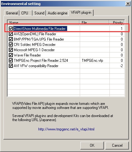

As far as TMPGEnc not opening your AVIs, try outputting them to DV-AVI if possible (you may need the Panasonic DV Codec). Also, go to Option > Environmental Setting > VFAPI plug-in, and make sure that DirectShow Multimedia File Reader is given the highest priority:

Second, I took your advice and did some tinkering with TMPGENC, with no good results. I then went and found online the MJPEG codec that Pinnacle uses for the card, installed that, and no luck. TMPGENC doesn't use it I guess. SO THEN I did the panasonic DV codec, and tried to output the file as that type of AVI with Studio7. Again..no luck. :P It locked up and wouldn't output the file.
So finally, I saw that DV FORMAT was one of the settings that Studio 7 has natively for AVI file output.
So....I output in that format, AND IT WORKS!!!
So at least this way I can capture with Studio7 as an mjpeg AVI, output (which happened pretty quickly) to a DV AVI, and then TMPGENC sees that and can open it easily..then I can tweak, adjust and edit using it.
