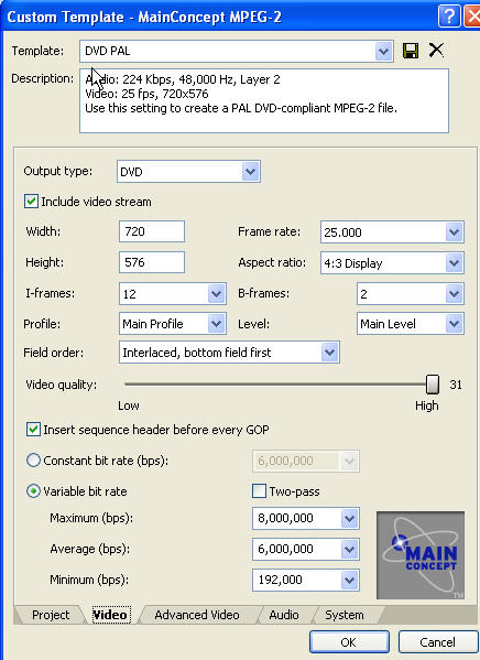

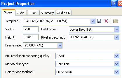

    The source is Mini DV (PAL). These are the project settings:
  6. and the render settings:
    [/img]
