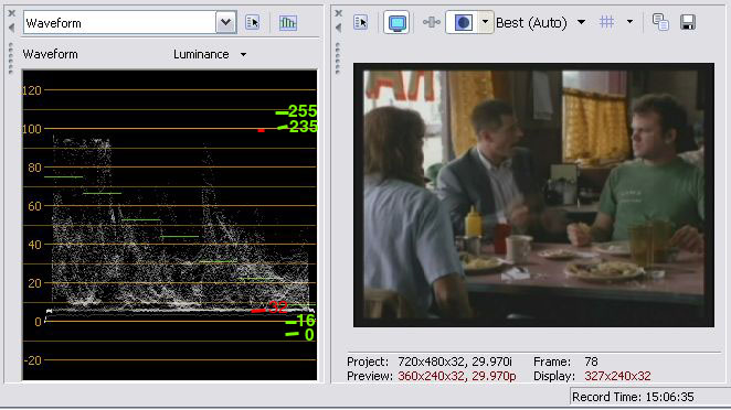

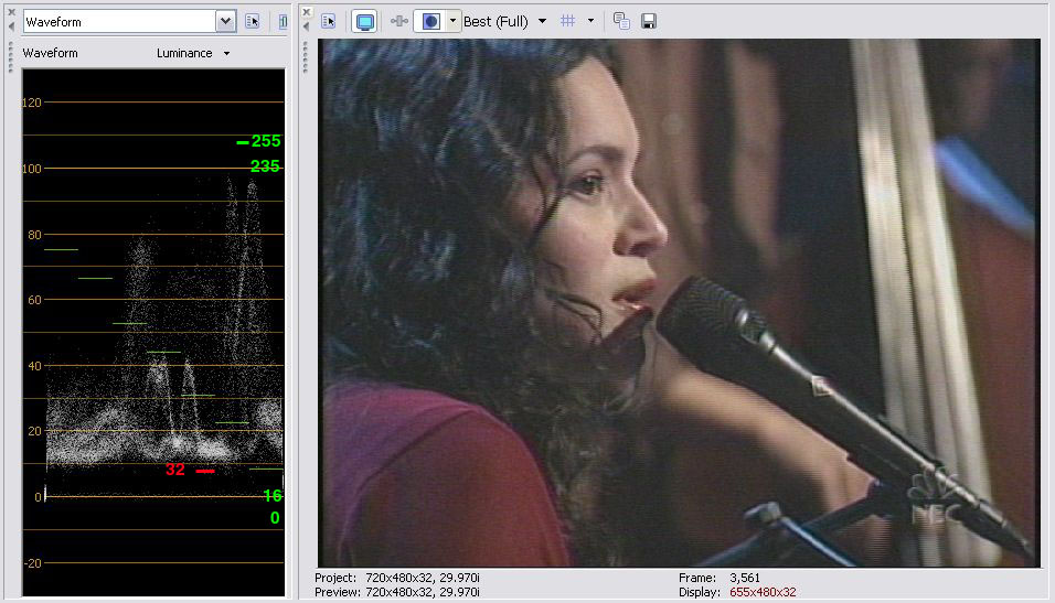

OK here is my first pass with Premiere 6.5. I checked the results with Vegas monitors using DV-AVI files, not MPeg2.
Capture: Here is a typical DV camcorder "pass-thru" capture of a 7.5-100 IRE cable channel. Black maps to 32 and white is near 235 digital levels. This is the typical "wash out" senario. If this is encoded to DVD as is, the DVD player will play out with 15 IRE blacks.

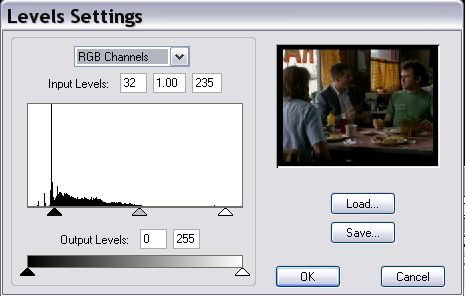

First filter tried is the Premiere 6.5 Levels filter (Video-Adjust-Levels) set to 32 and 235.
The result appears to set black to 16 and leaves white at 235 as desired.

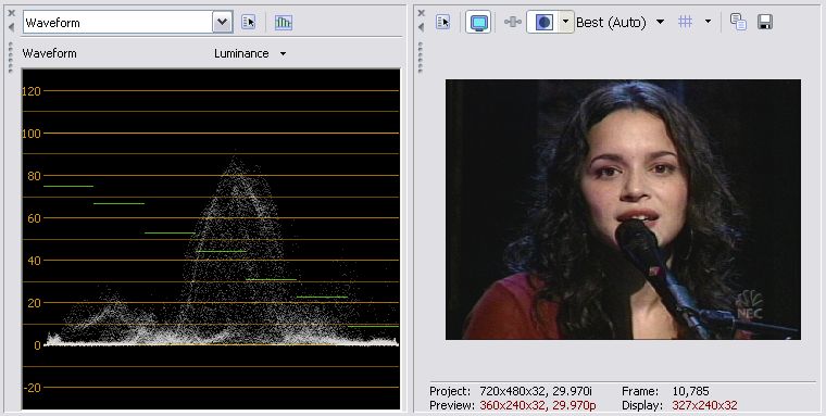

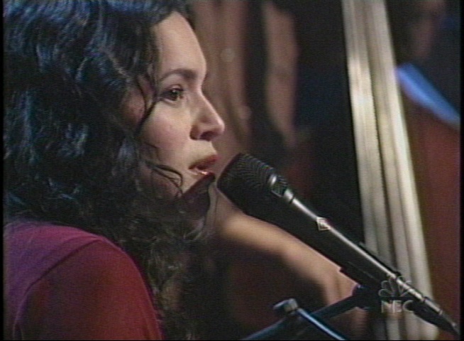

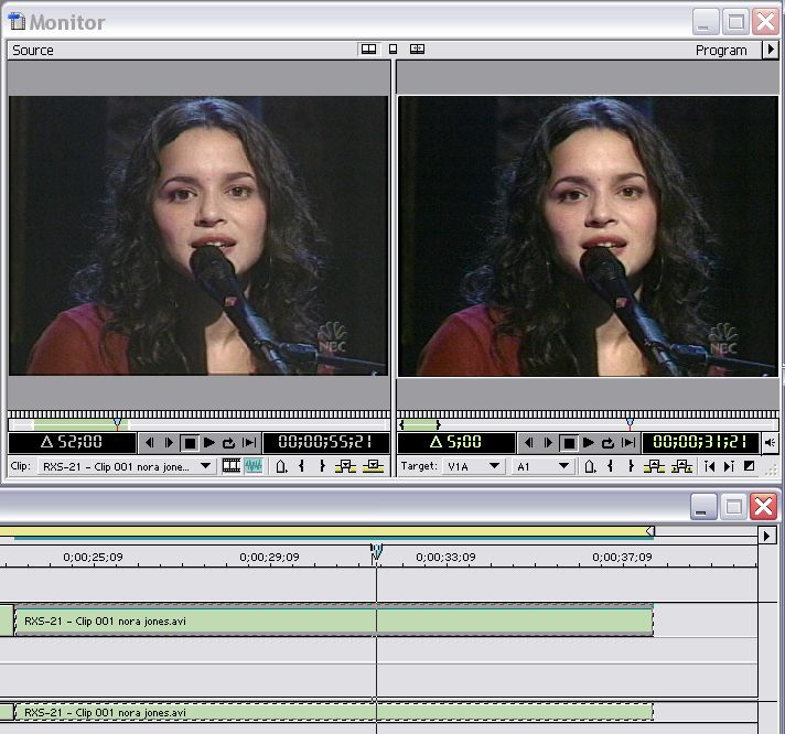

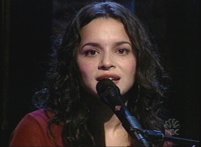

Good, here's another example of a DV camcorder capture.
Premiere 6.5 Levels filter only. Left is before, right is 32-235 setting.
And here it is on the Vegas waveform monitor.

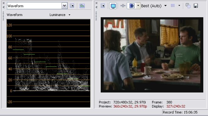

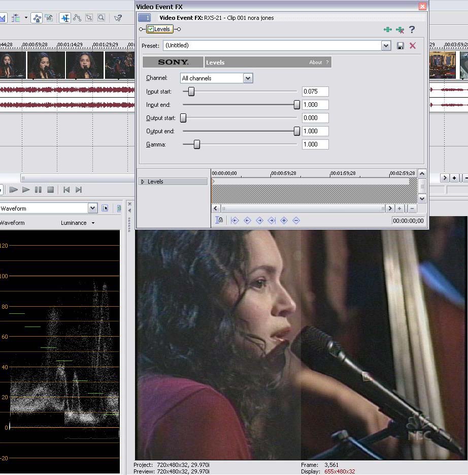

Here is a Vegas levels 7.5% correction to black level.
and the result. More could be done to enhance this clip. I'm just looking at black level here and it needs to be seen on a TV for full effect.

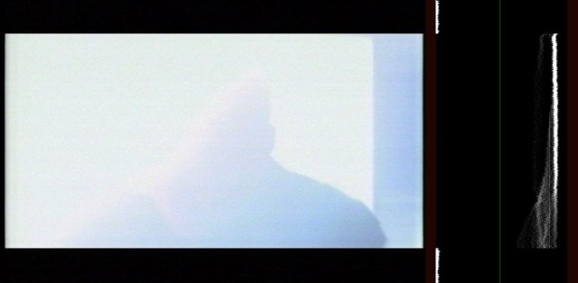

Okay I tried this myself. I am using captured DV from Canopus ADVC, and opened the script up into VirtualDub, and got the histogram on the side. Unfortunately, it doesn't seem accurate. I used a video clip with blown-out whites, up to 255. The graph kept all whites at maximum of 235. Everything is automatically compressed down into 16-235 range. Nothing ever goes outside this range. Why is that? The "colortools" plugin that has it's own histogram, does the same thing.Originally Posted by hrlslcbr
Not too many versions ago Vdub was having some color issues with DV. Are you using the latest version?

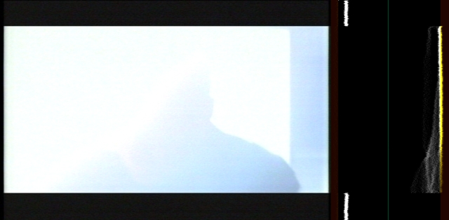

I tried 1.6.9 and 1.6.11 which is the latest version. I set my ADVC-300 brightness/contrast levels to MAX. Turned off Auto Gain, and set it manually to max. Everything is bright white, but still, nothing clips, according to Avisynth histogram. If I load the video in Vegas, it shows properly, with clipping. I tried "histogram() and histogram("levels")." Looks like VDUB histogram can't be trusted for DV sources.Originally Posted by dvd3500

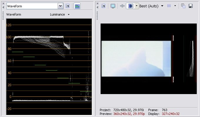

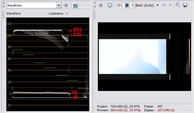

FWIW I put those two frames on the Vegas WFM (black 16 - white 235)
I'm not sure what this input waveform is.
b4 - black at 16, white at 255
after - black at zero, white at 235 (i.e. lunimance waveform moved down 7.5 IRE or 16 digital levels).
