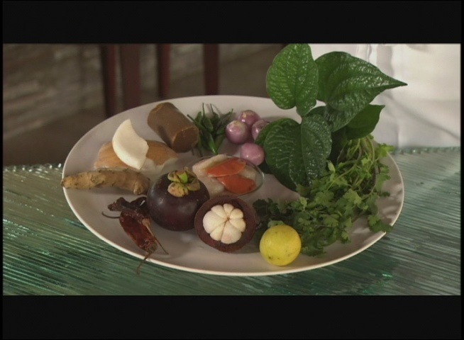

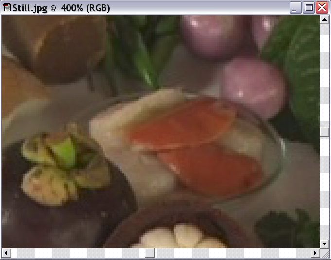

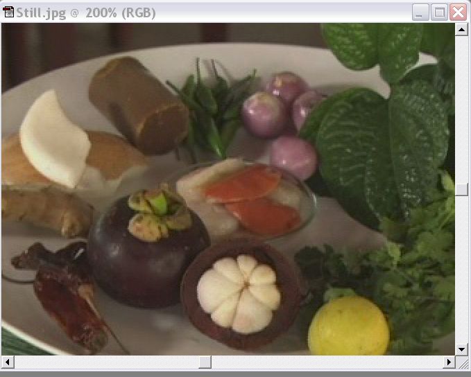

    Here is an off cable sample of the ADVC-100 480i 4:1:1. I don't see many obvious chroma sample issues.
    At 200% 4:1:1 is holding well
    At 400% the Y sampling is more visible than wide color pixels.
