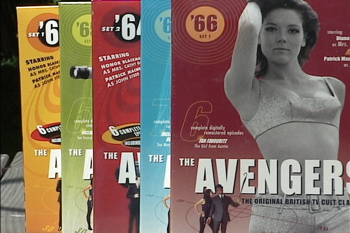

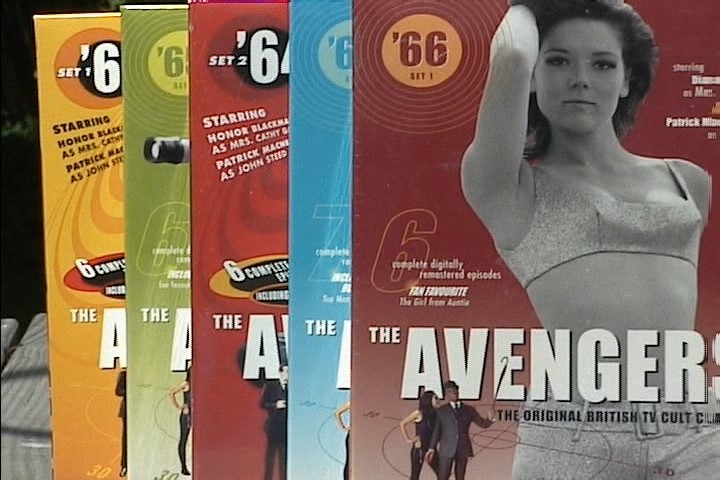

Here's what I get with NVE3 on a still frame:Originally Posted by AAA
Original DV AVI file:
NVE3 encoded VOB file 9600 kbps, interlaced, TFF:
Are your results worse with still frames? -

Yes, mine are worst..when I paused to take still frame, one can see the interlacing lines..?
Your images are very good.

BTW2: Both of your stills show improper DVD MPeg2 scaling. Both are clipped to 0 and 255. The second image shows a gamma shift compared to the first.Recommends: Kiva.org - Loans that change lives.

I just wanted to run a quick test with NVE3 (I don't normally use the program) to see if it gave "low resolution" results as AAA was indicating.Originally Posted by edDV
