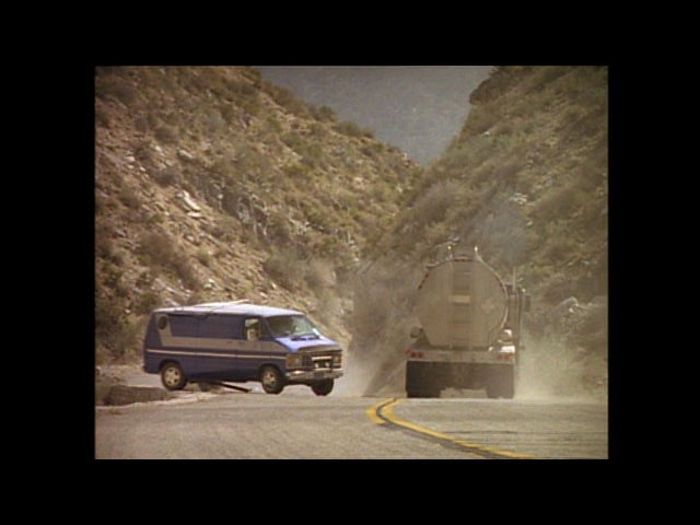

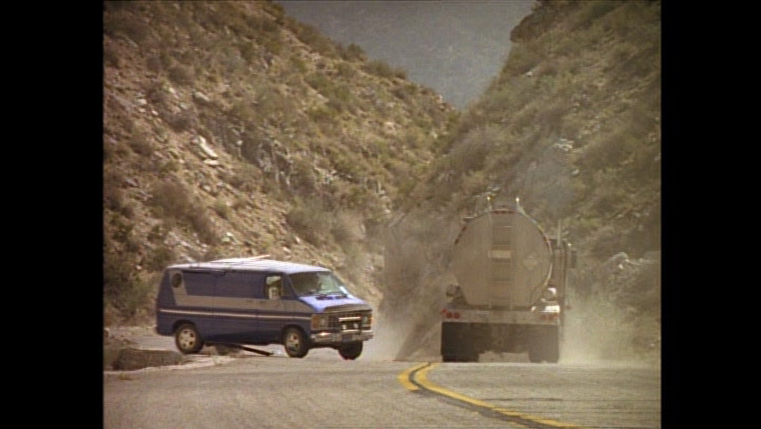

For instance I have an Anchor Bay DVD that has a bunch of trailers all on the same VTS and some are WIDESCREEN and some are FULL SCREEN so the FULL SCREEN trailers got encoded 16x9 and look like this:
VirtualDubMod image straight from DVD (720x480):
Resized for proper viewing on a computer monitor (852x480):
The first image is how it looked on the DVD and the second image is how it would look on your TV if you have a 16x9 TV. The problem is if you only have a 4:3 TV then you get the dreaded "postage stamp" look ... see image below:
This is what it looks like on a 4:3 TV:
