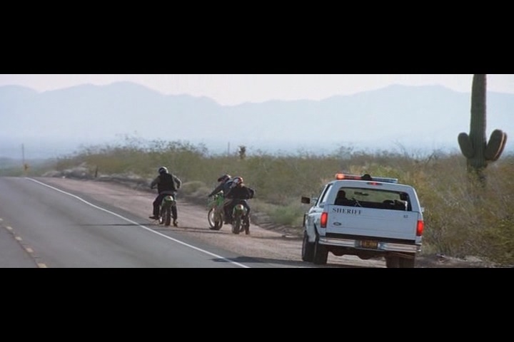

Just for fun:
A frame from a 608x256 900 kbps Xvid AVI file:
Resized with VirtualDubMpeg's Lanczos 3 filter (352x480), frame served to TMPGEnc, encoded as progressive MPEG2, Constant Quality 80 (1864 kbps average):
That 352x480 frame enlarged to 720x480 as your DVD player would:
I used lanczos 3 for this enlargment even though that's probably better (sharper) than the typical DVD player is capable of.
Now the original Xvid enlarged directly to 720x480 instead (2694 kbps average), same Constant Quality 80 setting in TMPGEnc:
The 720x480 conversion is obviously clearer than the 352x480 conversion. You can easily read the word SHERIFF on the back of the truck at 720x480.
What you can't see is how the video looks in motion. Since they were both compressed in Constant Quality mode they are very similar in terms of macroblocks, ringing, etc. The 720x480 conversion wasn't significantly worse than the original Xvid AVI when watched on TV. There was a little more macroblocking in the 720x480 conversion than in either the 352x480 conversion or the original Xvid. It wasn't really noticable except when viewing enlarged still frames. Neither video would improve very much by using a higher bitrate.
So yes, you could probably fit three or four 90 minute movies on one DVD using a 352x480 frame size. At the cost of a little loss of clarity.
