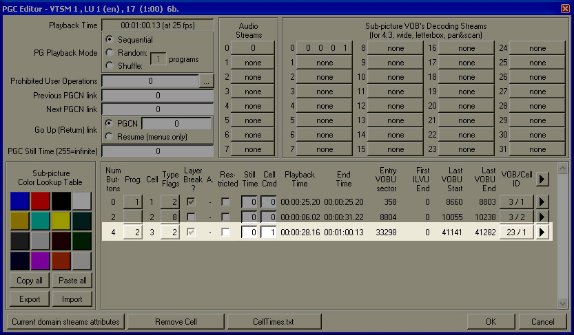

I'm trying to edit out the buttons on the Pirates Of The Carribean's Main Menu. They are:
1....Play
2....Bonus Material
3....Set Up
4....Scene Selection
I used PGC Edit 0.6.0 to Delete buttons 2 & 3, but when I select button 4 and then return to the main menu, buttons 2 & 3 are there again! I looked at the PGC and here's what I found:
It seems that the PGC has another set of four buttons in Prog 2, but how do I edit these out?
