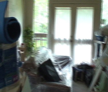

There are a lot of info on this subject here. As a person who knew nothing about the camcoders a days ago I am still need a little bit of help. At this moment I am trying to figure out the answer on 2 questions. I have just bought Sony DCR-HC90. THe video I shoot is interlaced. I have tons of very wide comb lines when I preview the video on my monitor(during the PANNING atound almost all objects).
I also see the comb lines on the LCD of the camera itself during panning.

I do not see comb lines artifacts on my TV. THe only thing I see are a lot of jagged edges during panning on all objects including stationary. Everything is "jagged" . I did call Sony and we did reset the camera, so all setting are default. The Sony people recommended to return the camera. Although, I want to make sure that it is a camera, not me being very particular. The Sony lady has no idea about the camcoders and that was very obvious.

I use firewire. Regarding software, I have used WinDV and Pinnacle Studio 9 with identical results. Some players also display constant flickering. I think it is nothing to worry about-just different players handle the recording differently. I couldn't find one player to get rid of the comb effect.

I finally made the windv work. First, It didn't want to record PInnacle captured files. It didn't want to record it's own files intil I've tried everything and accidentally found the cure
! I had to disconnect the firewire, started the Windv and started the recording. It showed the error: Device not found. O hooked up the camera and it worked! I love little accidental knowledge. It saves a lot of time. So, after recording the video back on the DV I think it looked the same as original. I captured the picture during playback on Light Alloy player. I also made the same ones with the PowerDVD.
I understand the difference on watching the video on TV and regular monitor. It is going to be TV eventually. My goal right now is to make sure that camcoder is OK. My concerns are: WinDVD/powerDVD doesn't make it look better. I've tried to play it on 2 different computers. I went to the store and made a clip with a lesser Sony camera to compare with mine, and I thought I can see less motion artifacts. Although, it could of been a better light source. I actually liked twice cheaper camera better! Hmm
My computer isn't too old yet I have MB nForce NF7-S V2 ABIT ATX; VGA XFX|GF FX 5600 128MB DDR;2800/333 ATHLON XP BARTON
Olga
