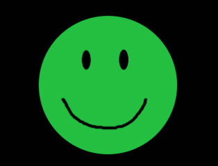

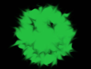

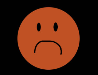

    I want to create an effect with two video clips. I want the first clip to sort of melt away and disappear and the second one takes its place. The entire clip may be 10 seconds long at very most, with the melt maybe taking 2-3 seconds at most.
    I want to re-iterate that even though these are stills in the example, I will be using motion clips fading into each other. Pretend the heads are shaking or something. I do not need "slideshow" software.
    I would prefer Adobe Premiere and/or After Effects, as I own those. Although, if needed, I can drive to somebody with Vegas or Final Cut Pro. And I'm open to hearing about others too.
    Some quick examples..
    And there we go. Ideas?

    The middle picture, the transition, looks like a smokey dissolve... Or maybe some kind of "melting" transition is required... I had a fairly hefty search on Google and Wrigley Video but nothing caught my eye...
