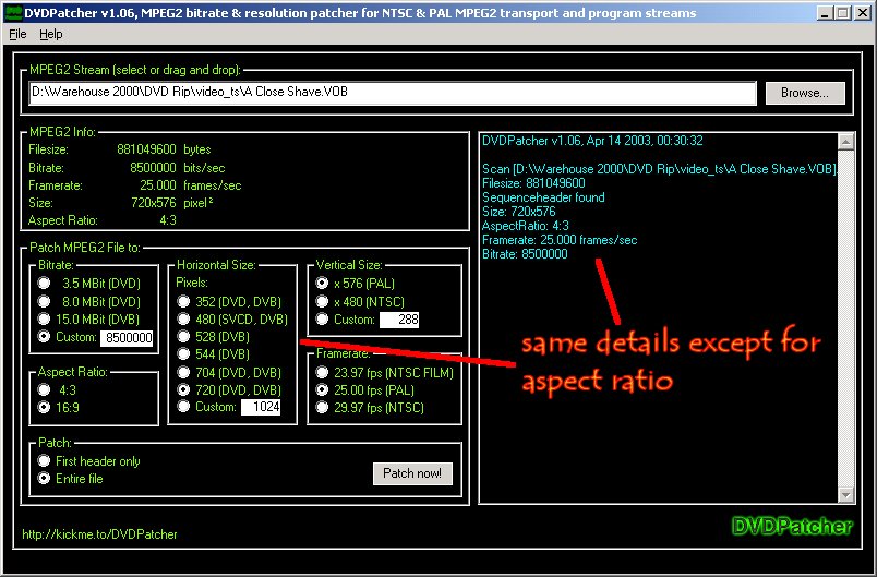

DVD Patcher is the one to use IMHO:
Firstly, using something like TMPGEnc DVD Author, convert the DVD to MPEG so that you get one continuous file. There are other programs that can use, but do a search on that one for your preference (although for example below I have used a vob). I believe that because you may be using the vob file and not the MPEG, this is why you are having the problems as I have sucessfully converted a DVD recorder captures file with the same issue.
Load the file up in DVD Patcher and look at the details on the right. You need to make the settings on the left the same except for the aspect ratio which you should set to 16:9 and that you are going to patch the entire file.
example:
When you press Patch Now!, the only difference between the two sets of settings (that the system wants you to check) will be the aspect ratio.
Apply the settings and once finished, re author to DVD and this should now play on the correct aspect. It may be worth pointing out that if someone's DVD playback of this is still at 5:4 squashed, they may need to change the output settings on the DVD player.
I hope that this is helpful.
Edit I have just tried to convert a raw Vob from a DVD Recorder capture and DVD Patcher doesn't like it : "No Sequencer Header Found". Will further investigate.
Edit 2Re-tested a DVD Recorder capture (Sony) and the convert to MPEG (TDA) then using DVD Patcher as above works perfectly.Cole -
